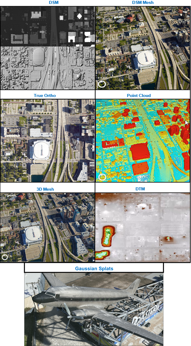

Reality mapping products
Products generated in ArcGIS Reality for ArcGIS Pro are shown. Imagery is courtesy of LeadAir, Inc.

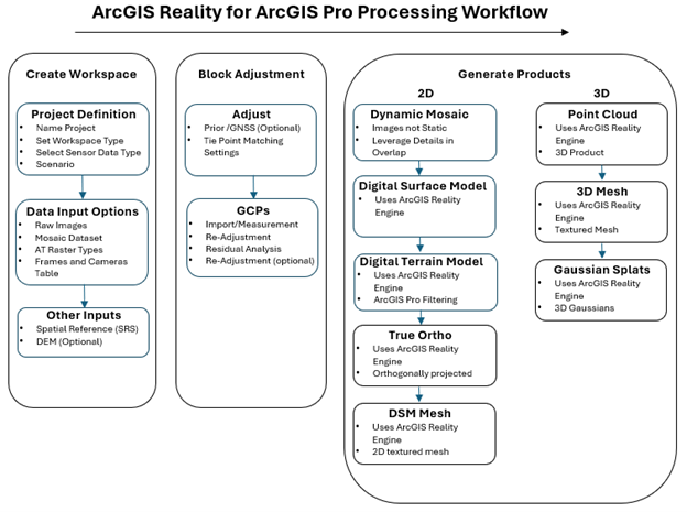

Reality mapping with ArcGIS Pro requires three main steps:
  • Create a Reality mapping workspace.
  • Perform a block adjustment to correct geometric distortions in the imagery.
  • Generate Reality mapping products.
Reality mapping project overview
First, create a project. Then create a Reality mapping workspace, which is a subproject in the ArcGIS Pro project. The workspace manages all the Reality mapping resources and opens a map view with a Reality Mapping tab and a Reality Mapping view in the Contents pane for the Reality mapping workflow. The Reality Mapping tab provides tools and wizards for bundled block adjustment and the generation of Reality mapping products. The Reality Mapping view in the Contents pane manages and visualizes the layers of the related data in the Reality mapping workspace.
The Reality mapping workspace, and the data stored in it, depend on the source data. You can create a Reality mapping workspace for digital aerial, drone, and satellite imagery. In the Reality Mapping wizard, you can provide a folder containing images, or you can use an existing mosaic dataset.
When the Reality mapping workspace is created, a Reality Mapping category is created in the Catalog pane. Expand this to see the Reality mapping workspace you created, which includes an Imagery folder containing the source imagery and a Products folder where the Reality mapping products are stored.
The Contents pane contains a variety of layers associated with the Reality mapping workspace, such as Control Points, Solution Points, and Data Products. These layers are empty until you initiate the proper steps in the Reality mapping workflow. For example, the Control Points layer is populated after you perform a block adjustment, and the Data Products layer is populated after you complete the Reality mapping product generation steps.

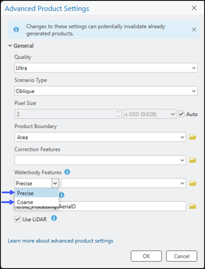

  • Product Boundary—Inputs a shapefile to define the extent of the output product and reduce processing duration. It is recommended that you input a project boundary before creating derived products.
  • Correction Features—Inputs a shapefile used to correct errors in the DSM, such as regularizing building shapes. This improves the output quality of the True Ortho and mesh products.
  • Waterbody Features—Inputs 3D shapefiles used to hydrologically constrain features, such as lakes and wide rivers, that fall within the project area. If water features exist within the project area, add water body features to improve the quality of derived products. There are two options when adding a water body feature to the project: Precise and Coarse.
    Waterbody Features parameter
    Use the Precise option when adding a 3D polygon that accurately defines the shape of the hydrological features in the project area. Precise polygons can be created using the 3D Stereo Mapping application in ArcGIS Pro, or when using the 2D heads-up digitizing tools with authoritative, orthorectified imagery that is temporally similar.
    Use the Coarse option when a generalized 3D polygon is used as the water body feature. Generalized polygons can be created using the 2D heads-up digitizing workflow. If 2D heads-up digitizing is used to create a precise or coarse polygon, it must be converted to 3D (x,y,z) before it can be used as a water body feature. For information about converting a 2D feature to 3D, see Get z-values from an elevation surface, or use the Interpolate Shape geoprocessing tool.
    In the absence of a water body features shapefile, lake surfaces may appear highly irregular and adversely impact product quality. It’s important that the height of water body features closely match the terrain height of the features being constrained in the project. Discrepancies in height will introduce distortions such as image stretching in the output product. Accurate water body feature polygons can be derived using the Stereo Mapping app in ArcGIS Image Analyst.
