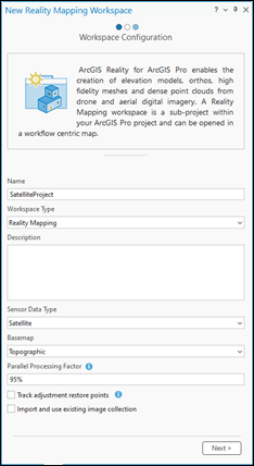

  1. On the Imagery tab, click New Workspace.
  2. On the Workspace Configuration page, provide a name for the workspace.
  3. Ensure that Workspace Type is set to Reality Mapping.
  4. From the Sensor Data Type drop-down list, choose Satellite.
  5. Optionally, from the Basemap drop-down list, choose a basemap as a backdrop for the image collection.
  6. Optionally, set the Parallel Processing Factor value of the workspace. The default value of 50% means that half of the total CPU cores will be used to support Reality mapping processing.
  7. Optionally, check the Track adjustment restore points check box to be able to revert your workspace to a previous state.
  8. Optionally, check the Import and use existing image collection check box to import and use an existing mosaic dataset. See Create a Reality mapping workspace from a mosaic dataset for more information.
    New Reality Mapping Workspace wizard Workspace Configuration page

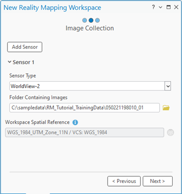

  10. On the Image Collection page, from the Sensor Type drop-down menu, choose an appropriate sensor type from the list of satellite sensors.
  11. For Folder Containing Images, click the Browse button and browse to the folder on disk containing the imagery, select it, and click OK.
    The supported Workspace Spatial Reference information is automatically populated, and the option to add the spatial reference information manually is unavailable. If the system cannot automatically determine the appropriate spatial referencing, manual entry of this information is enabled.
  12. If the appropriate spatial referencing was not set automatically, for Spatial Reference, click the Browse button and choose a map reference system, vertical coordinate system, and set the Current XY and Current Z coordinates for the project.
    When processing satellite imagery in Reality mapping, the planimetric (x,y) coordinate system must be defined using the WGS84 UTM reference frame, and the vertical coordinate system must be WGS84.
  13. Click OK to close the Spatial Reference window.

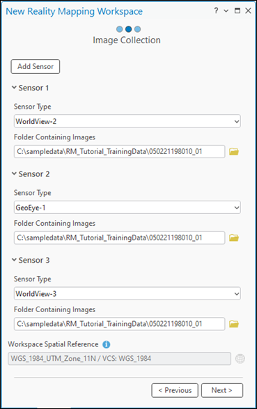

  15. If you're working with multisensor satellite imagery, click the Add Sensor button to add more sensor types.
  16. Repeat steps 10 through 12 to define the additional sensor parameters.
    Add multiple sensors to an image collection.

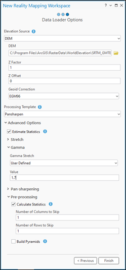

  18. On the Data Loader Options page, specify an Elevation Source value, or use the default DEM.
  19. If you use a DEM as the Elevation Source value, set the Geoid Correction value.
    If the local DEM has ellipsoidal height, select None from the Geoid Correction drop-down list. If the DEM has orthometric height, select EGM96.

  21. Expand the Advanced Options section.
    The available options will vary based on the processing template selected. For example, if an atmospheric compensation (Acomp)-type template is selected, the Stretch and Gamma options will not be available but will be available for all other Processing Template types.
  22. Expand Gamma.
  23. For Gamma Stretch, select User Defined from the drop-down menu, and provide an appropriate value.
    For example, 1.7 works well with Maxar and Airbus imagery.
  24. Expand Pre-processing.
  25. Ensure that the Calculate Statistics check box is checked.
    Note:
    If statistics were previously calculated for the imagery using the Build Pyramids and Statistics geoprocessing tool, this step can be skipped.
  26. For Number of Columns to Skip and Number of Rows to Skip, ensure that the value is 1.
  27. Accept all other default values, and click Finish to create the workspace.
