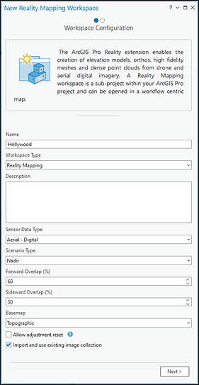

  1. On the Imagery tab, click New Workspace.
  2. On the Workspace Configuration page, provide a name for the workspace.
  3. Ensure that Workspace Type is set to Reality Mapping.
  4. From the Sensor Data Type drop-down list, choose a type that matches the data managed by the mosaic dataset.
    Scenario Type is automatically set based on the Sensor Data Type value selected. It is recommended that you do not change this setting.
    Optionally, if Sensor Data Type is set to Aerial - Digital, adjust the Forward Overlap and Sideward Overlap values if required.
  5. Optionally, set the Parallel Processing Factor value of the workspace. The default value of 50% means that half of the total CPU cores will be used to support Reality mapping processing.
  6. Check the Import and use existing image collection check box, and click Next.
    Workspace Configuration page for mosaic datasets
