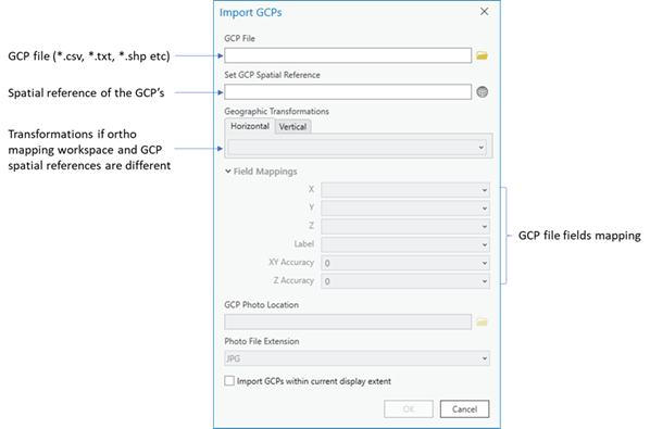

To import GCPs into the Reality mapping workspace from existing ground survey data, complete the following steps:
  1. Click the Manage GCPs drop-down menu and click the Import GCPs button Import GCPs.
    The Import GCPs dialog box appears.
  2. For GCP File, click the Browse button Browse and browse to the location of the GCP file.
    The GCP file can be a .csv or .txt file, feature class, or shapefile. The GCP file should include the Label, X coordinate, Y coordinate, Z coordinate, XY accuracy, and Z accuracy fields.
  3. For Set GCP Spatial Reference, browse to and specify the horizontal and vertical coordinate systems of the GCPs.
    If the coordinate system of the GCPs is different than that of the Reality mapping workspace, specify the horizontal and vertical geographic transformations to apply.
  4. For Field Mappings, specify the fields in the GCP file that correspond to the field mapping parameters listed.
  5. For GCP Photo Location, if the GCP data includes photos of the locations where GCPs were measured, browse to and select the folder containing the photos.
    The name of the photo must match the GCP Label field value. If there are multiple photos for each GCP, the name of the photo must include a number appended to the Label field, which will be used as a unique identifier. For example, GCP20_1.jpg and GCP20_2.jpg are the photos for GCP20.
  6. Optionally, check the box to import only the GCPs that exist within the current display extent; otherwise, all GCPs are imported.
  7. Click OK.

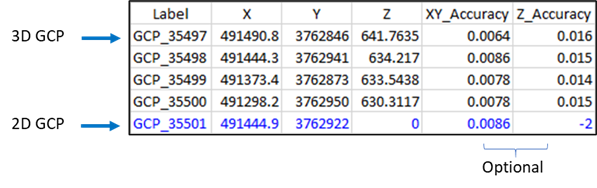

2D GCPs added to a .csv file must adhere to the format below. 1D GCPs cannot be added to a .csv file. Instead, add 1D GCPs using the workflow described in the Add GCPs manually section above, steps 6-9.
Format for GCPs in a .csv file
