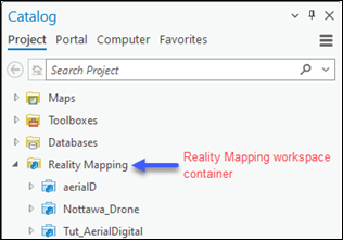

Save a copy of the workspace
To save a copy of the workspace, complete the following steps:
  1. In the Catalog pane, expand the Reality Mapping workspace container.
  2. Right-click the workspace to be copied and click Copy from the drop-down list.
  3. Right-click the Reality Mapping workspace container and click Paste.

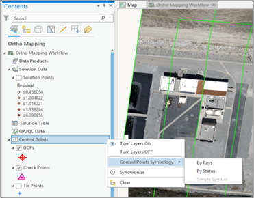

Adjust layer symbology
Once you have performed an adjustment, the Solution Data and Control Points layers are populated in the Contents pane. To adjust layer symbology, right-click the layer, select the layer symbology, and choose a method for displaying the associated points. Layer groups can also be turned on and off.

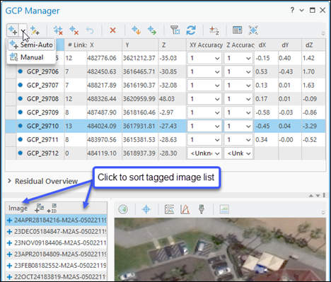

GCP Manager
Use the GCP Manager pane to add, edit, and manage control points so they can be used in Reality mapping projects. If the GCP Manager pane does not have any rows in the table, it means that there are no GCPs or tie points currently associated with the Reality mapping project. If you have GCPs saved in a file, you can import them using the Import GCPs button . If you do not have a GCP file, you can create GCPs using Compute GCPs from the Manage GCPs drop-down menu. You can also create GCPs using the Semi-Auto button , or the Manual GCP button .

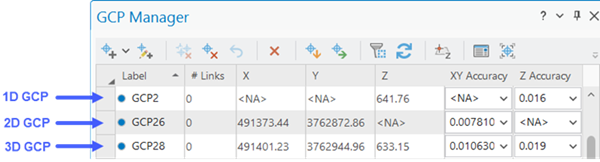

In addition to importing, GCPs can be added manually to the GCP Manager by using the Enter GCP Manually button . Once selected, a new row will be added to the GCP Manager table. The GCP ID, X, Y, and Z fields can be edited or updated with the respective coordinate information. The XY Accuracy or Z Accuracy field can be used to classify a GCP as a 1D, 2D, or 3D point. Use the following as a guide when reclassifying a GCP.
  • If adding a one-dimensional (1D) coordinate, enter the height value in the Z field and set the XY Accuracy field value to NA. Optionally, input the GCP Z Accuracy value.
  • If entering a two-dimensional (2D) coordinate, add the X and Y coordinates to the appropriate fields and set the Z Accuracy field value to NA. Optionally, enter the GCP XY Accuracy value.
  • If entering a three-dimensional (3D) coordinate, add the X, Y, and Z coordinates to the appropriate fields. Optionally, set the GCP XY Accuracy and Z Accuracy values.
Note:
Double-click in each field to enter 3D values in the GCP Manager table. A 3D GCP can be converted to a 1D or 2D GCP by setting the XY Accuracy or Z Accuracy fields to NA.
GCP Manager with 1D, 2D and 3D GCPs
When 2D or 3D GCP coordinates are entered in the GCP Manager table using the Enter GCP Manually button, a pending GCP symbol will be displayed in the 2D map view highlighting the GCP's location. The accuracy of the displayed GCP location is directly related to the accuracy of the map. It is recommended that a surveyor-supplied description or image showing the GCP location be used to guide point identification and measurement. 1D GCPs that do not have X and Y values will not be displayed on the map.

Selecting the first GCP in the GCP Manager results in a list of overlapping images in the image Preview section. Manually locating and tagging the GCP in the first image in the list will result in the auto-tagging of the same GCP in corresponding images using image correlation.
Note:
While GCP autocorrelation works to tag GCPs on a single image using Semi-Auto , it is recommended that a minimum of two images be manually tagged before using Semi-Auto to tag a third image.
In cases where all images were not tagged during the autocorrelation process, manually tagging an untagged image will result in autocorrelating the outstanding images.
Once the images have been tagged, single clicking Image on the image list menu bar will sort the image list by a quality score, in lowest to highest order. Single clicking Image a second time will reverse the sorting order.
