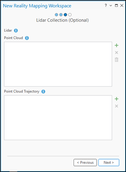

  17. Optionally, add lidar data in the LiDAR Collection (Optional) page to support the product generation stage of the process. Click Next to continue.
    Note:
    Add lidar point cloud and trajectory data using the optional LiDAR Collection page. This additional 3D data improves the quality of True Ortho, DSM, DSM Mesh, and 3D Mesh, products. The lidar data must have been collected simultaneously with the imagery to be processed. LAS or LAZ are acceptable formats for the Point Cloud data. For Point Cloud Trajectory, an SBET or SOL file is required. Both the Point Cloud and Point Cloud Trajectory files are mandatory requirements when integrating lidar data in the Reality mapping process.

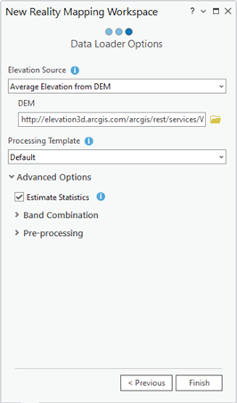

  18. On the Data Loader Options page, define the output workspace characteristics.
    1. Choose an Elevation Source value. Creating a Reality mapping workspace from aerial imagery requires elevation data.
      The DEM parameter wizard provides an elevation service with a 90-meter resolution by default; however, this only allows for coarse orthorectification. You can use a different DEM service or file by browsing to it.
      • If you have internet access, use the default elevation service for the DEM parameter, and choose Average Elevation from DEM for the Elevation Source value.
      • If you do not have internet access, provide a DEM file covering the project area, and choose Average Elevation for the Elevation Source value.
    2. In the Advanced Options section, check the Estimate Statistics check box to estimate the statistics for the output workspace.
    3. Optionally, edit the Band Combination parameters to reorder the band combination from the default order.
    4. Choose a Pre-processing option, Calculate Statistics or Build Pyramids, to perform on the data before you create the workspace.
      Data Loader Options page for a digital aerial workspace
