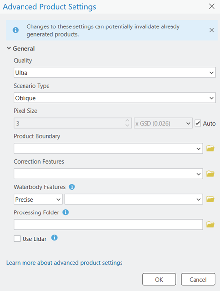

  2. Click Shared Advanced Settings.
    The Advanced Product Settings dialog box appears, where you can define parameters that will impact the Reality mapping products that will be generated. For a detailed description of the advanced product settings options, see Shared Advanced Settings in the wizard.
  3. If a full resolution True Ortho product is required, ensure that Quality is set to Ultra, and to manually define the True Ortho output resolution, for Pixel Size, select Meters from the drop-down menu, and provide the required pixel size.
    The Quality and Scenario Type settings are automatically set by the application and should not be changed to ensure optimum performance and product quality. However, if you want to generate a reduced resolution product, the Quality setting can be lowered. See Shared Advanced Settings in the wizard for more information about the impact of various quality settings on product generation.
