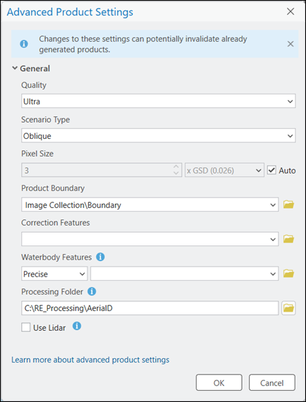

  2. Click Shared Advanced Settings.
    The Advanced Products Settings dialog box appears, where you can define parameters that will determine all Reality mapping products to be generated. For a detailed description of the advanced product settings options, click the Learn more about advanced product settings link at the bottom of the dialog box.
    Advanced Product Settings dialog box for generating a Gaussian splats product
    The Quality and Scenario Type settings are automatically set by the application and should not be changed to ensure optimum performance and product quality. However, if you want to generate a reduced resolution product, you can lower the Quality setting. See Shared Advanced Settings above for more information about the impact of the various Quality options on product generation.
  3. For Product Boundary, select a feature class identifying the output product extent from the drop-down list or click the Browse button and browse to one.
    It is recommended that you specify a project boundary for the following reasons:
    • Define the proper output extent—When you do not define a product boundary, the application automatically defines an extent based on various dataset parameters that may not match the project extent.
    • Reduce processing time—If the required product extent is smaller than the image collection extent, defining a product boundary reduces the processing duration and automatically clips the output to the boundary extent.

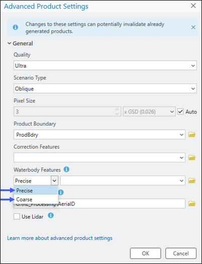

  4. To specify a water body feature layer, click the Browse button next to Waterbody Features.
    Note:
    If water body features, such as lakes and rivers, exist within the project area, it is recommended that you add a pre-created 3D feature class identifying those areas, using the Waterbody Features setting to hydrologically enforce those features in the output product. Use the stereoscopic compilation in ArcGIS Image Analyst to generate the 3D feature layer that identifies water body features. This ensures that there will be no image stretching around hydrological feature boundaries in the output due to differences in elevation between the derived digital surface model (DSM) height and the feature class height values.
    There are two Waterbody Features options: Precise and Coarse. Use the Precise option when the 3D polygon being added accurately defines the shape of the hydrological features in the project area. Precise polygons can be created using the stereoscopic compilation in ArcGIS Image Analyst. A precise water body polygon can also be derived from national mapping organizations with open data policies. Additionally, it can be created using 2D heads-up digitizing from an authoritative, orthorectified imagery that is temporally similar, with the aid of a DEM.
    Use the Coarse option when a generalized 3D polygon is being used as the water body feature. Generalized polygons can be created using a 2D heads-up digitizing workflow. If 2D heads-up digitizing is used to create a precise or coarse polygon, it must be converted to 3D (x,y,z) before it can be used as a water body feature. See Introduction to 2D and 3D features for additional information about converting a 2D feature to 3D. When using a coarse water body feature, the shape of the polygon must follow the shape of the water body feature for best results.
  5. For Processing Folder, click the browse button , and browse to and define the Reality Mapping temporary folder location.
    The temporary files required for generating 2D or 3D products are stored here.
  6. Ensure the Use LiDAR is unchecked.
    Lidar integration in Gaussian Splats product generation is not supported.
    Note:
    Lidar captured simultaneously with the images being processed can be integrated into the Reality mapping workflow at the workspace creation stage to enhance the quality of the True Ortho, DSM, DSM Mesh, and 3D Mesh products. This option will be unavailable if the lidar point cloud and trajectory data was not previously added to the workspace.
  7. Leave all the other default settings and click OK.

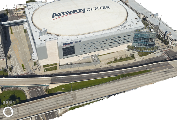

    Gaussian Splats tiles
  9. To visualize the generated Gaussian Splats layer, click Meshes > Gaussian Splats to expand the folder in the Reality Mapping container. Right-click the 3D_Tiles layer, and click Add to New > Local Scene
    Gaussian splats layer
