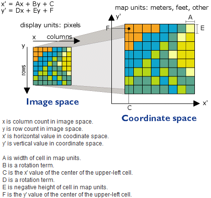

The first-order polynomial transformation is commonly used to georeference an image. Use a first-order or affine transformation to shift, scale, and rotate a raster dataset. This generally results in straight lines on the raster dataset mapped as straight lines in the warped raster dataset. Thus, squares and rectangles on the raster dataset are commonly changed into parallelograms of arbitrary scaling and angle orientation. Below is the equation to transform a raster dataset using the affine (first order) polynomial transformation. You can see how six parameters define how a raster's rows and columns transform into map coordinates.
Cell unit to coordinate affine transformation
With a minimum of three control points, the mathematical equation used with a first-order transformation can exactly map each raster point to the target location. Any more than three control points introduces errors, or residuals, that are distributed throughout all the control points. However, you should add more than three control points, because if one control is inaccurate, it has a much greater impact on the transformation. Thus, even though the mathematical transformation error may increase as you create more links, the overall accuracy of the transformation will increase as well.
