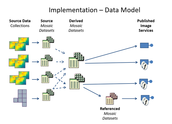

Although you can create a single mosaic dataset from many collections of imagery, the best practice is to use a combination of mosaic datasets. This is described in the following sections and diagrammed in the graphic below.
Source, derived, referenced, and published mosaic datasets
Source data collections are stored in source mosaic datasets that can be combined into derived mosaic datasets, which are then used to create referenced mosaic datasets and published image services.
