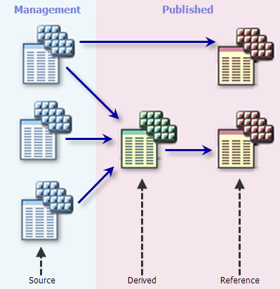

Organization of mosaic datasets
The organization of mosaic datasets can become more complex as you need to manage different types of data. Two standard combinations that you can use to manage and publish imagery are illustrated below.
General configurations of a mosaic dataset
It is generally advantageous to separate mosaic datasets into two types: those that are primarily used for management and those that are published. This separation can aid in organization.
As you build and organize a collection of imagery using mosaic datasets, it is useful to understand the different types of mosaic datasets and what purpose they may serve. The source and derived mosaic datasets discussed below are symbolic names used to help convey an understanding of the organizational structure of mosaic datasets, whereas a reference mosaic dataset is a physically different form of a mosaic dataset.

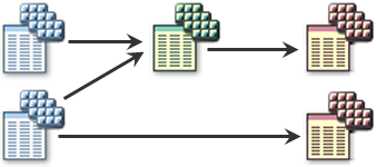

Derived mosaic datasets
The derived mosaic dataset is used to define collections of imagery often viewed by users as a single collection. The source of a derived mosaic dataset is generally one or more source mosaic datasets. For example, this can be a collection of all natural color imagery, with the source coming from multiple source mosaic datasets. It is recommended that you provide access to (publish) this mosaic dataset using a reference mosaic dataset to keep it secure. Additionally, you can create other mosaic datasets from a derived mosaic dataset to provide specific imagery products—such as a specific band combination—or only over a specific area.
Source mosaic datasets added to derived mosaic dataset
The image and raster data are added via a mosaic dataset to a derived mosaic dataset.
A derived mosaic dataset is also created using the Create Mosaic Dataset tool. Often the input imagery will have various bit depths and bands, so you should specify these values or define a product definition to control the output of the mosaic dataset. Additionally, choose a spatial reference system that can accommodate all the imagery.
The spatial reference system is used to generate the footprints, boundary, and other related items in the mosaic dataset, as well as a default with which the mosaicked imagery will be resampled. Choose one that is suitable for all the imagery you may add. This can be a country system or UTM zone. However, if you're creating a mosaic dataset that may be global in extent or will be mashed up with web services, you may want to use the WGS 1984 Web Mercator Auxiliary projection.
It is recommended that you add a source mosaic dataset to another mosaic dataset using the Table raster type. Using the Table raster type creates a mosaic dataset containing all or a selection of the table items in the source mosaic datasets, not only a single item representing the source mosaic dataset. This gives you the ability to perform queries and continue to access the individual metadata for each item. You can also add functions to individual items and more easily customize the mosaic dataset with seamlines, mosaic methods, and color corrections. Additionally, you can use the Synchronize Mosaic Dataset tool with the Update cell size ranges option disabled to update this mosaic dataset if any of the sources have been modified, such as modified footprints or new imagery that has been added.
If you add the source mosaic datasets using the Raster Dataset raster type instead of the Table raster type, each source mosaic dataset will be represented as a single item in the derived mosaic dataset. This limits your ability to perform queries, limits metadata access to the source mosaic dataset instead of each image, and limits the scalability of the mosaic dataset.
Generally, you do not build overviews for this mosaic dataset, as the overviews exist in the source mosaic datasets. However, it may be necessary to build them if the derived mosaic dataset covers a much greater extent than each source. Instead of building overviews, you can use another image or image service to provide imagery coverage for the full extent of the mosaic dataset. When adding this image, you should uncheck the option to build the boundary because the boundary will be extended to the extent of this image—which may not be ideal.

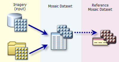

Referenced mosaic datasets
Referenced mosaic datasets behave similarly to a regular mosaic dataset; however, you cannot add additional rasters to the referenced mosaic dataset, you cannot build overviews, and you cannot calculate the pixel size ranges. You can redefine the boundary, for example, to restrict access to specific areas or define additional functions to be applied to all imagery. It is used to provide access to mosaic datasets with different mosaic dataset-level functions. Sharing access to a referenced mosaic dataset ensures that those accessing it cannot make modifications to the source or derived mosaic datasets, which may affect other users.
Reference mosaic datasets are created using the Create Referenced Mosaic Dataset tool and by defining another mosaic dataset as the source. Typically, this source can be a source mosaic dataset or a derived mosaic dataset.
Reference mosaic datasets created from other mosaic datasets
Reference mosaic datasets are only created from other mosaic datasets.
Any properties set on the input mosaic dataset are carried over to the reference mosaic dataset—such as the default mosaic method—or mosaic dataset functions. You can modify or remove any of these without affecting the input mosaic dataset. You can modify the functions or properties by opening the mosaic dataset's Properties dialog box from the Catalog pane.

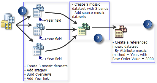

Multiple orthoimage collection example
You may have a collection of aerial imagery from three years, such as 2010, 2015, and 2020, to create a time series mosaic dataset. Ideally, each of these collections should have similar image properties, including the number of bands, spatial resolution, bit depth, and time of year (temporal resolution). Matching the properties of the images will allow for easier comparison to determine change and compare the images. Since the mosaic dataset will have a specific number of bands, bit depth, and spatial resolution, you must determine how to best fit the input data. Since existing mosaic datasets can be used as input for a reference mosaic dataset, you can create one mosaic dataset that references the source mosaic datasets. These mosaic datasets can be used for time series analysis or to store all of the available imagery in a collection of the particular study area.
If the spatial resolutions vary, you may need to choose the minimum mapping unit for your workflow or analysis. When the spatial resolution varies, the Min/Max PS in the mosaic dataset will also change, which may alter the visibility of the images. There are two ways to organize this data: as separate source mosaic datasets and one combined derived mosaic dataset, or as one mosaic dataset. Using a combination of source and derived mosaic datasets generally makes the management easier while maintaining optimum performance.
  1. To do this, create three source mosaic datasets. You can specify the band and bit depths when you create them or allow the software to define them when the data is added. Creating pyramids for pregenerated tiles generally does not bring benefits, so pyramid generation can be skipped. But you should build overviews on each of the source mosaic datasets. This way, when you query the derived mosaic dataset by date as you zoom the image, it will be consistent. If the collections do not have overviews, you need to build overviews on the derived mosaic dataset, and this can only be generated for a single attribute date. Modify the attribute table for each collection by adding the same new field for the Year and populate the field with the year.
    Workflow diagram
  2. Create one derived mosaic dataset containing three bands. This one will be used to provide the best color imagery combination. Then add the three source mosaic datasets to it using the Table raster type and the Update cell size ranges option disabled. You won't have to build overviews, as they were already created in each source mosaic dataset. You may want to modify some of the properties, such as defining the mosaic method to be By Attribute and specifying the default year, such as 3000, to display using the latest imagery.
  3. It is recommended that you create a reference mosaic dataset to publish the contents of the derived mosaic dataset if the access will be directly to the dataset. If you're publishing the mosaic dataset as an image service, you can publish it directly. In either case, you will have one dataset to access, query, and explore.
Add data
When you obtain new orthoimagery, create a source mosaic dataset. Then add the source mosaic dataset to the original derived mosaic dataset using the Table raster type and build overviews. By default, the new imagery is visualized immediately because the By Attribute mosaic method was defined earlier.
