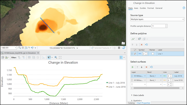

Specify whether the chart will be created for a single raster layer or multiple layers using the Source type parameter.
  • Single layer—The chart will be created for the selected layer.
  • Multiple layers—Charts can be created for multiple layers that intersect the polyline feature that you will draw.
Surface profile created from two layers.

You can use the Draw tool in the Chart Properties pane to draw a polyline feature on the raster layer, mosaic dataset, or multidimensional raster layer in the map view. This line feature is added to the feature table in the Chart Properties pane. In the feature table, you can deselect or delete the line feature and edit the symbol and label. The marker check box is used to show the sample points of the profile in the chart, which is off by default. You can also draw a surface profile by selecting an existing line feature that intersects with the raster layer.
Select surfaces
When generating a chart for single or multiple layers, you can select the bands or layers to graph using the layer table. This table allows you to select one or multiple surfaces from which to graph the profiles. If the source type is Single Layer, the surfaces can be raster bands and you can select one or multiple bands. Slices of a multidimensional raster are also supported, and you can select slices by defining the dimensions. If the source type is Multiple layers, the surfaces are layers.
The Surfaces table also allows you to specify the width of the line in the chart and the label that appears in the chart legend and tooltips.
