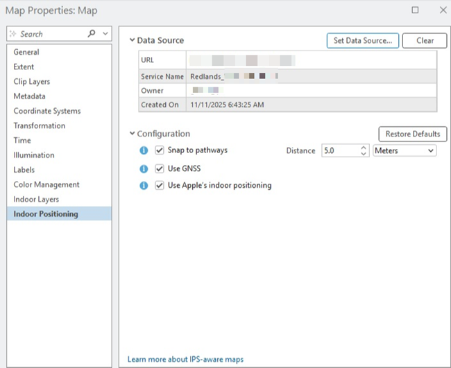

  3. In the Contents pane, right-click the map and click Properties.
    The Map Properties dialog box appears.
  4. Click Indoor Positioning on the side of the dialog box.
    The Indoor Positioning properties tab is only available to IPS-licensed users.

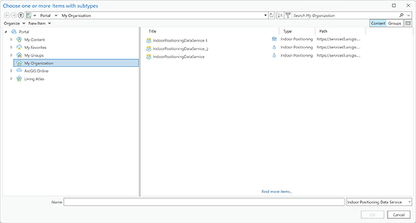

  5. Click Set Data Source in the Data Source section.
    The Choose one or more items with subtypes dialog box appears.
  6. In the active portal, browse the available Indoor Positioning Data Service items, and select the item that contains positioning data for the map.
    Indoor Positioning Data Service property
  7. Click OK.
    The Indoor Positioning Data Service is now associated with the map. The Configuration section under Indoor Positioning is enabled and can be used to configure the IPS-aware map.
    Indoor Positioning Data Source
    Note:
    If you want to disable IPS awareness in the map, click Clear to remove the selected Indoor Positioning Data Service.
  8. Click Apply to apply the changes, and click OK to close Map Properties.
