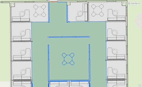

You must create IPS area features to represent the indoor areas where geometry-aided indoor positioning will be enabled.
If users can move between adjacent IPS area features, ensure that the features are geometrically connected. If adjacent IPS areas are disconnected, the system treats them as separate positioning regions. The blue dot may not transition smoothly between them, which can reduce indoor positioning performance.
Indoor map with IPS area polygons highlighted.

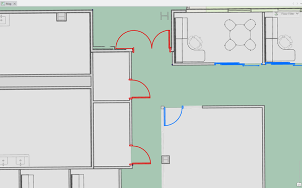

Ensure that the selected obstacle features layer includes a LEVEL_ID field.
When choosing an obstacle features layer, ensure that the layer contains only features that represent impassable barriers, such as walls, columns, or doorways, that restrict access to traversable spaces. Passable features that allow user movement within an IPS area, such as hallway doors, should not be selected as obstacles. Only impassable features should be treated as barriers.

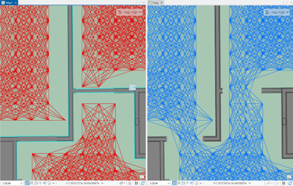

Comparison of connectivity graphs with traversable doors included or excluded as obstacles.
Features within the IPS area (white) that represent traversable objects, such as doors (black) or staircases, should not be included in the selected obstacle features. In the above example, the left image shows a configuration where the connectivity graph is disconnected near the door features because they were selected as obstacle features. The right image shows a configuration where the connectivity graph connects adjacent corridors because the doors were excluded from the selected obstacle features. This is the correct configuration, which allows the blue dot to move more easily through the walkable space within the IPS area.

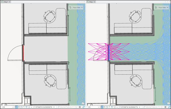

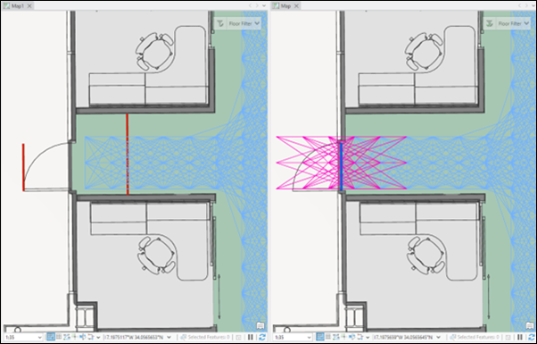

Entrance and exit features are lines representing the transition between indoor and outdoor spaces. If you specify a layer for the Entrance / Exit Features parameter in the Add Geometry To Indoor Positioning Dataset tool, the tool generates indoor-outdoor transition edges or indoor-outdoor transition polygons to support a seamless transition between these areas.
Indoor maps showing indoor-outdoor transition edges or a polygon for an entrance/exit.
If entrance and exit features are provided (green line), the tool generates indoor-outdoor transition edges in the connectivity graph format, or an indoor-outdoor transition polygon in the classification grid format, to enable a smooth transition from the indoor space to the outdoor space.
Note:
A transition is considered valid and is only processed by the tool if it results in the creation of indoor-outdoor edges in the connectivity graph format or an indoor-outdoor transition polygon in the classification grid format. For this to occur, the transition line feature must be placed within 2 meters (6.5 feet) of both the Level layer border and IPS Areas layer border.
