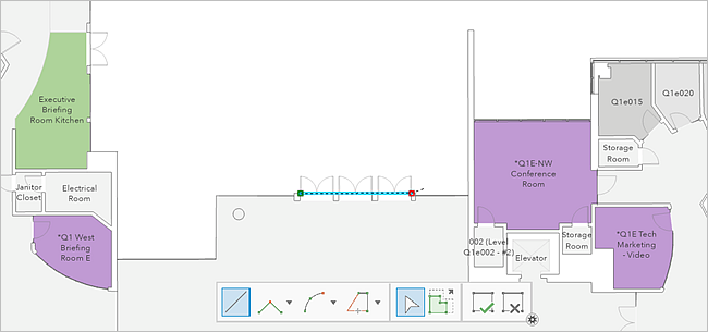

  7. In the Create Features pane, click Line to create a line feature.
  8. Click one side of an entrance or exit to start the feature creation.
  9. Create the endpoint of the line at the other side of the entrance or exit.
    Example of creating an entrance or exit line feature in an ArcGIS Pro project
    Note:
    Valid entrance and exit transition lines must consist of exactly two vertices.

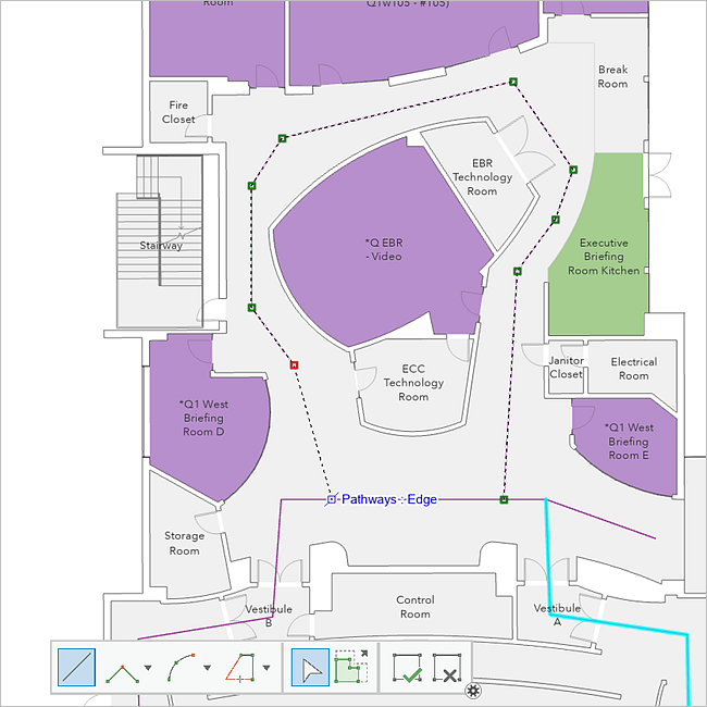

  8. Draw a line along traversable areas designated for indoor positioning, as shown in the example below.
    Example of creating a pathway line feature
    Note:
    When creating pathways, ensure that the parallel lines are spaced farther apart than the configured Path Snapping Distance. Additionally, it is recommended that you create only one pathway per corridor or hallway, positioned in the center, to optimize user experience.
