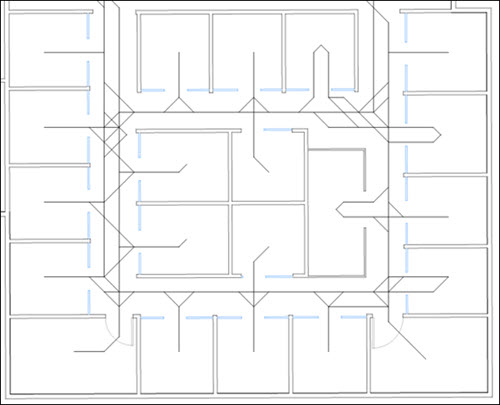

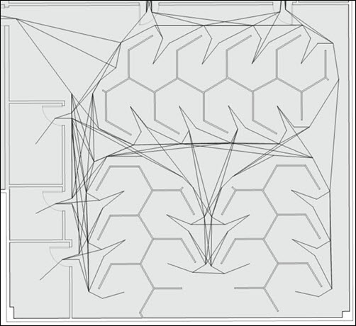

Universal circulation network
The universal circulation network approach generates pathways based on shortest paths between routable locations, more closely resembling the walking path that a person might take in a space. This algorithm is best suited for buildings that have multiple orientations or lots of curves or non-90 degree angles.
Universal Circulation Network pathways reflecting organic walking paths in a space unsuited for 90 degree angles

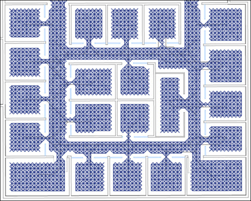

Lattice
The lattice approach creates a fishnet across the walkable spaces of the level with a density determined by the value entered for the Lattice Spacing parameter.
The Generate Indoor Network Features tool attempts to align the lattice of pathways with the primary direction of travel in each facility. If the pathway features don't align with underlying spaces, you can set a custom lattice rotation value.
Preliminary pathways include an unthinned lattice connected through specified doorways. Finalized pathways include a thinned lattice that ensures connectivity between all routable locations.
