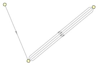

  1. Select relationships that meet the required criteria for grouping relationships.
    It may help to change which link chart layers are selectable in the Contents pane to avoid selecting relationships of different relationship types. You can select only one of the relationships that meet the criteria. Any entities selected in the link chart will be discarded as part of the grouping process.

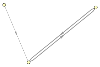

    Several relationships exist between two entities in both directions.

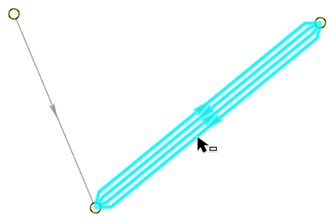

    All relationships between the entities are selected.
  2. On the Link Chart tab on the ribbon, in the Visualization group, click the Grouping drop-down arrow, and click Group Relationships .
    If more relationships in the link chart meet the grouping criteria than the selected relationships, all relationships that meet the criteria will be grouped. The relationship group is selected on the link chart. An error message will appear if the criteria for grouping relationships aren't satisfied.

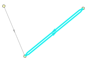

    Relationships in the same direction are grouped together and the groups are selected.

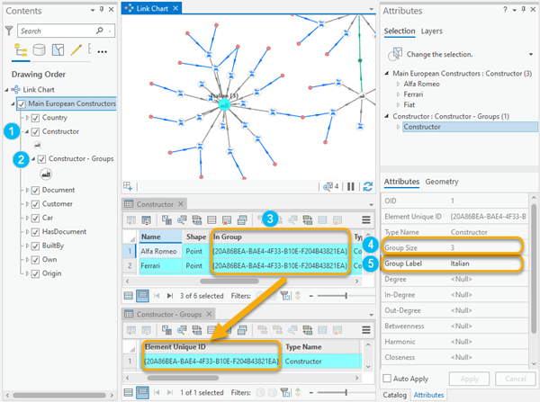

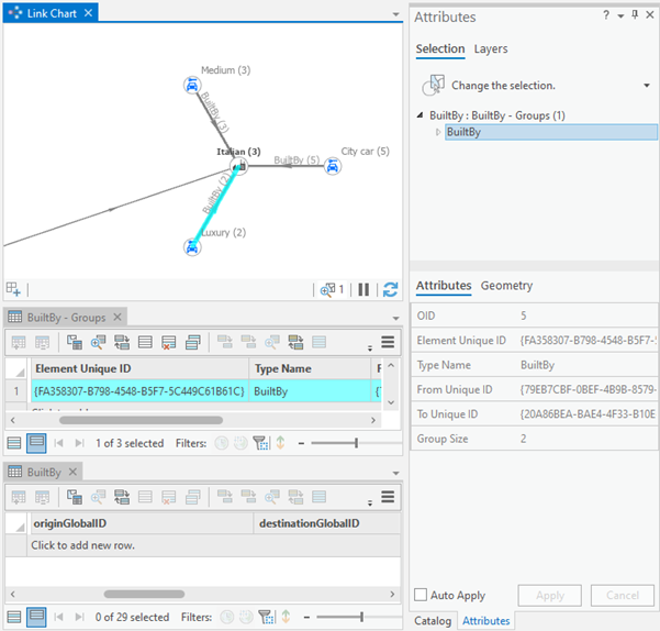

The link chart layer (number 1 in the image below) represents entities or relationships in the knowledge graph. The link chart aggregation layer (number 2 in the image below) represents entity groups or relationship groups in the link chart.
Each entity or relationship in a link chart layer has an In Group attribute (number 3 in the image below). When entities and relationships are grouped, the group is assigned an Element Unique ID value. For an entity or relationship in the group, the In Group attribute value indicates the Element Unique ID value of the group. For any entity or relationship that is not grouped in the link chart, the In Group attribute value is null.
Attributes on the entity/relationship groups and grouped entities/relationships
For an entity group or relationship group in a link chart aggregation layer, there is a Group Size attribute (number 4 in the image above). The Group Size is the number of entities that participate in the entity group or the number of relationships that participate in the relationship group.
Entity groups also have a Group Label attribute that can be edited to provide a name for the entity group (number 5 in the image above). By default, this attribute value is set to the shortest name among all entities in the group.
Data related to groups in a link chart

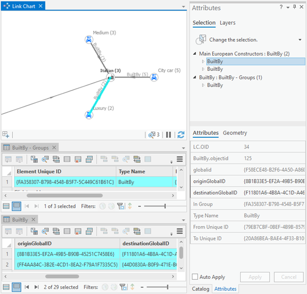

By default, when selecting an entity group or a relationship group, the Attributes pane shows attributes for both the group and any individual entities or relationships that participate in the group, and the pane identifies how many groups are selected as well as how many individual graph items participate in the group. Rows are also selected in the attribute table for both the link chart aggregation layer and the link chart layer. This behavior is determined by the Automatically select related data setting on the link chart aggregation layer's Layer Properties dialog box.
The graphic below shows the content displayed in the Attributes pane and the rows that are selected in the attribute tables when the default setting is used. In this example, one BuiltBy relationship group is selected in the link chart. Two individual BuiltBy relationships participate in the relationship group. You can explore properties of the individual BuiltBy relationships in the attribute table for the BuiltBy link chart layer or the Attributes pane.
Data related to a relationship group is selected by default.

In the graphic below, the same relationship group is selected in the link chart when the Automatically select related data option is unchecked. The Attributes pane only displays information for the link chart aggregation layer—the BuiltBy relationship groups. The individual relationships that participate in the BuiltBy relationship group are not selected automatically in the BuiltBy link chart layer and are not available in the Attributes pane.
Data related to a relationship group can optionally not be selected by default.
