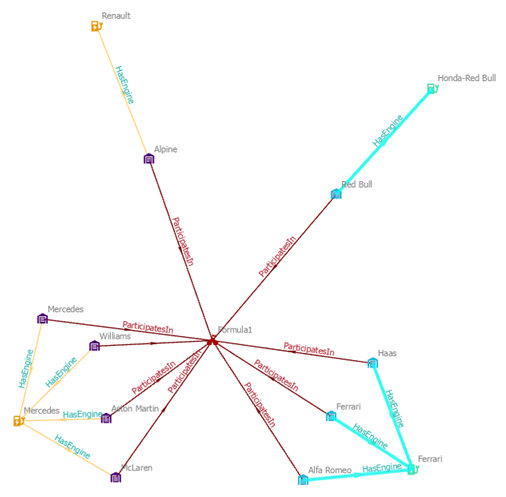

Remove selected entities and relationships
Remove entities and relationships from a link chart by completing the following steps:
  1. Select entities and relationships you want to remove from the link chart.
    Entities and relationships are selected on the link chart.
  2. On the Link Chart tab on the ribbon, in the Scope group, click Remove .
All selected entities and relationships, including selected entity groups and relationship groups, are removed from the link chart. When a selected entity is removed, any relationships in which it participates that are present in the link chart are also removed from the link chart, even if they are not selected. Similarly, if an entity group is removed, any associated relationship groups are also removed. To remove individual entities or relationships that are in a group, you must ungroup the entities or relationships and select the individual graph items you want to remove.
The selected entities and their associated relationships are removed from the link chart.

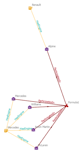

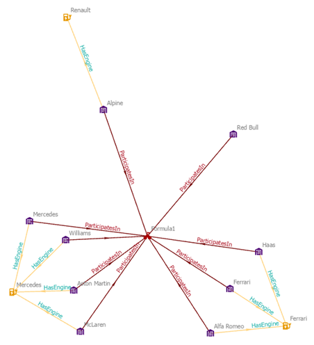

Trim leaf entities
If you plan to trim a selected set of entities and relationships, some of the selected graph items must not be leaf items or relationships connected to leaf items. If you select a leaf entity or a relationship connected to a leaf entity and click Trim , content is not removed from the link chart.
Trim entities and relationships on a link chart by completing the following steps:
  1. If you want to trim a selected set of entities and relationships only, select the appropriate graph items on the link chart.
  2. On the Link Chart tab on the ribbon, in the Scope group, click Trim .
Leaf entities on the link chart are removed along with any relationships on the link chart in which the leaf entities participate.
Leaf entities and their associated relationships are removed from the link chart.
