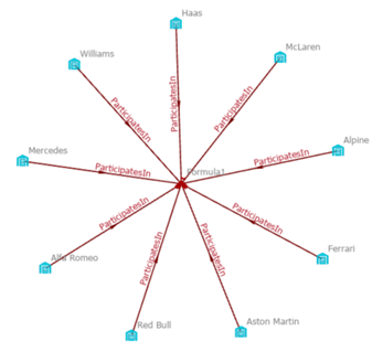

Expand an entity using all relationships
When you use the Expand method to add content to a link chart, the operation executes from all selected entities. All relationships of all types for all selected entities are evaluated. The relationships and the related entities are added to the link chart whether the selected entities occupy the origin or the destination of the relationship. For example, if a store is selected in the link chart, all relationships existing between this store and employees, warehouses, suppliers, and transportation vehicles are added.

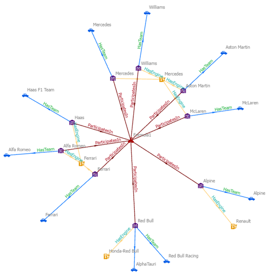

  2. On the Link Chart tab on the ribbon, in the Scope group, click the Expand menu and click Expand .

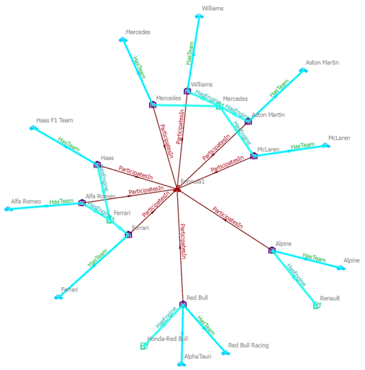

    The originally selected graph items are deselected. The relationships and related entities identified by the expand operation are added to the link chart and selected. This allows you to click Expand again if you want to expand one more degree from the newly added entities.
    The added entities and relationships are selected automatically.

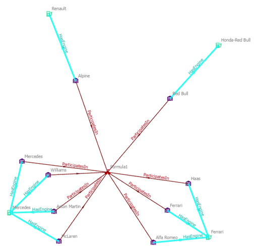

    One relationship type, HasEngine, is selected on the dialog box.
  4. Click the Filtered Expand button at the bottom of the window.
    The originally selected graph items are deselected. The relationships and related entities identified by the filtered expand operation are added to the link chart and selected.
    Relationships and related entities identified by the filtered expand operation are added to the link chart and selected.

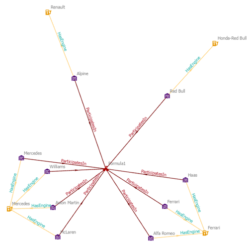

  5. Optionally, clear the selection and zoom in to explore the added relationships.
    No items are selected on the link chart after the selection is cleared.
