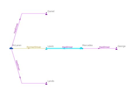

Select neighbors on a link chart
When a link chart has a set of selected entities and relationships, you can click the Select Neighbors button to add adjacent graph items to the selected set. When an entity is selected, all relationships in which it participates that are included on the link chart are added to the selection along with the entities at the other end of each relationship.
An entity, its relationships, and the entities at the other end of each relationship are selected.
When a relationship is selected, the Select Neighbors operation adds the origin and destination entities for the relationship to the selection.
A relationship and its origin and destination entities are selected.

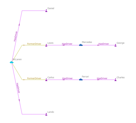

Select entities between entities
The Select Between operation examines the selected entities and determines if there are entities on the link chart that are directly connected to two or more selected entities. Entities directly connected to only one of the selected entities are not considered. Any entity with more than one degree of separation from the originally selected entities are not considered. For example, you can use this operation to identify people on the link chart who are key intermediaries in a social network or important suppliers in the supply chain.
This algorithm only processes selected entities. A minimum of two entities must be selected on the link chart. If an entity group is selected, each entity in the group is processed individually.
Once the in-between entities have been identified, the originally selected entities are deselected and the in-between entities are selected.
If no entities satisfy the requirements, a message indicates that no common entity was found on the link chart. For example, in the illustration below, no entities on the link chart are between any of the three originally selected entities. Additional relationships may connect the three entities to each other, but since they are not present on the link chart, they are not considered by the operation.

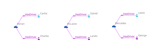

Three entities are selected on a link chart.
When comparing the Select Between and Find Between operations, Select Between considers only entities and relationships that are present on the link chart. However, Find Between examines the underlying knowledge graph and adds entities that satisfy the criteria to the link chart if they are not present.

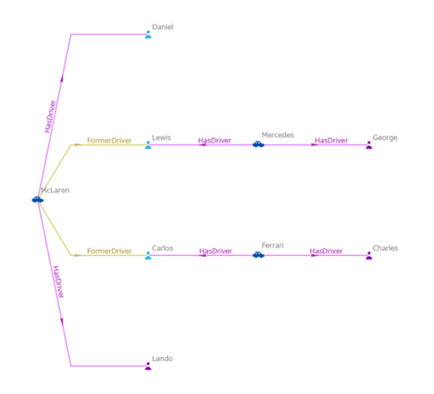

  1. Select two or more entities.

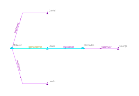

  2. On the Link Chart tab on the ribbon, in the Selection group, click the Advanced Selection drop-down arrow , and click Select Between .
    Entities on the link chart directly connected to two or more of the originally selected entities through relationships present on the link chart are identified. The originally selected graph items are deselected and the in-between entities are selected.
    Entities directly connected to two or more of the originally selected entities are selected.
