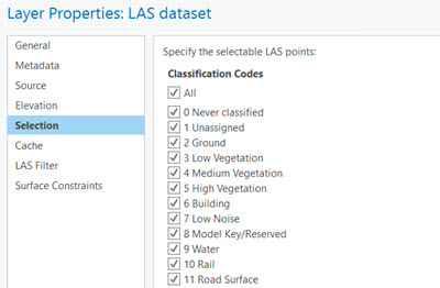

Click Selectable Points to open the layer properties of the LAS dataset, .las file, or .zlas file. From the Layer Properties dialog box, you can specify which points are selectable for the LAS dataset layer. The classification codes in the LAS dataset are listed on the Selection tab. You can make certain classification codes selectable using the check boxes. This is useful when you are interactively classifying points. For example, you may want only the unclassified points to be selectable points to reclassify certain features that are currently unclassified points. You can also access the Selection tab by clicking Selectable Points on the Classification tab, in the LAS Dataset Layer tab group.
LAS dataset layer properties Selection tab

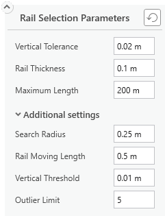

The Rail smart selection tool selects a series of points along a line based on a smaller selection or by double-clicking rail line points in a 3D scene. When you select a few points or double-click points along a rail line, the tool automatically selects several points along the line until the parameters are exceeded. Once points are selected, they can be reclassified to the rail line classification code. It is recommended that you zoom in as closely to the points as possible to ensure that you are selecting the points along a line. You may need your camera position to be below the lines for the best results in 3D. Consider using the Selectable Points option to select only the points that are assigned a certain class code.
Rail Selection Parameters
  • Vertical Tolerance is the allowable variation in the Z dimension to determine whether a point is a rail point and will be included in the selection. The default is 0.02 m.
  • Rail Thickness limits the search distance to the left and right along the rail. The default is 0.1 m.
  • Maximum Length is the longest allowable distance in both directions along the rail for selecting points as rail points. The default is 200 m.
  • Search Radius is the distance from the moving window's endpoints within which a point is assessed as a rail point. The default is 0.25 m. A good value for the search radius should allow for jumping gaps but not be excessively large, as a larger value will significantly slow down the selection tool.
  • Rail Moving Length is the length of the moving window (active set of points) that continuously moves along the rail after selecting a rail point. If the value is too small, the selection may go off track. If it is too large, it will struggle with turns but will perform better when crossing railroad tracks. The default is 0.5 m.
  • Vertical Threshold is the minimum above-ground distance for a point to be considered a rail point. The default is 0.01 m.
  • Outlier Limit is the maximum allowable number of outliers. If the number of outliers is below this limit, they are excluded from selection. The default is 5 points.
