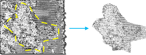

Creates LAS files from point cloud data in a LAS dataset or point cloud scene layer.
Illustration
Extract LAS tool illustration

  • You can use the Extraction Boundary parameter to clip the input point cloud to an irregular shape. This parameter supports a polygon boundary that defines a contiguous study area, such as a single polygon feature covering a relatively large region. While multiple polygons representing neighboring areas of interest can be provided as input, the boundary feature does not support polygons that represent a large number of small features such as trees or buildings. Multiple polygons are merged to efficiently clip the input point cloud. Because of this, avoid specifying a boundary feature with many small polygons, which will result in slow performance.
