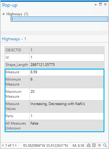

When using the Explore tool to view linear features that contain measured values (m-values), six additional measure fields display in the pop-up when you click a feature.

Pop-up displaying measure information
Field name
Description
Measure
Displays the measure for the identified linear feature.
Note:
Viewing m-values in the measure field is not supported for global and local scenes.
Minimum Measure
Displays the minimum measure for the identified linear feature.
Maximum Measure
Displays the maximum measure for the identified linear feature.
Measure Values
Displays measure behavior such as increasing, decreasing, NaNs (NaN is an acronym for Not a Number), and levels within the identified linear feature.
Parts
Displays the number of segments (for instance, if the linear feature is split) that comprise the identified linear feature.
All Measures Unknown
A Boolean value (true/false) indicating whether all measure values contain NaNs.

  1. On the ribbon, click either the Map tab or the Linear Referencing contextual tab. In the Navigate group, ensure that the Explore tool is selected.
  2. Use one of the following methods:
    1. On the map, click a linear feature with measures.
      The Pop-up pane appears with attributes for the identified feature along with six additional fields that display at the bottom of the list when the identified feature contains measures.
