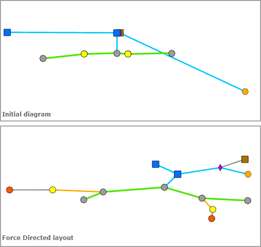

The images below show a sample diagram before and after applying the Force Directed layout:
Sample diagram before and after applying the Force Directed layout

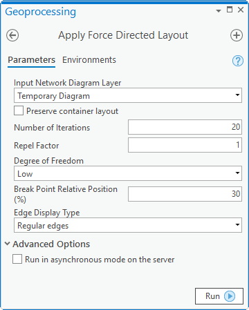

Force Directed layout parameters
Apply Force Directed Layout parameters
The sections below clarify the main Force Directed diagram layout parameters.

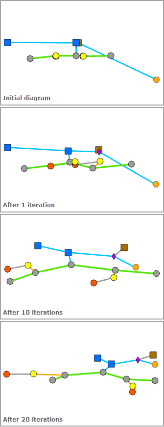

Number of Iterations
The number of iterations to process.
The images below show the difference in the resulting diagrams when increasing the number of iterations with the same repel factor and degree of freedom:
Force Directed—Number of Iterations

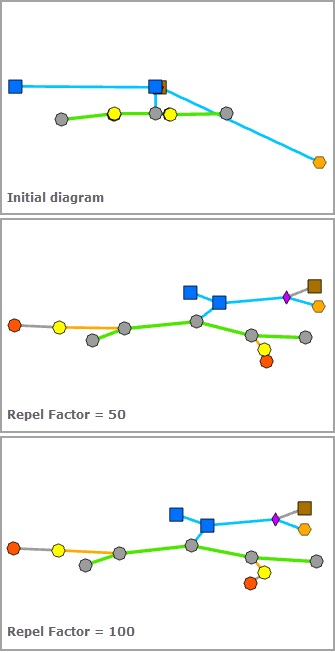

Repel Factor
This parameter is used to add distance between diagram junctions that are close together. The larger the repel factor, the greater the distance that will be added between nearly overlapping diagram junctions.

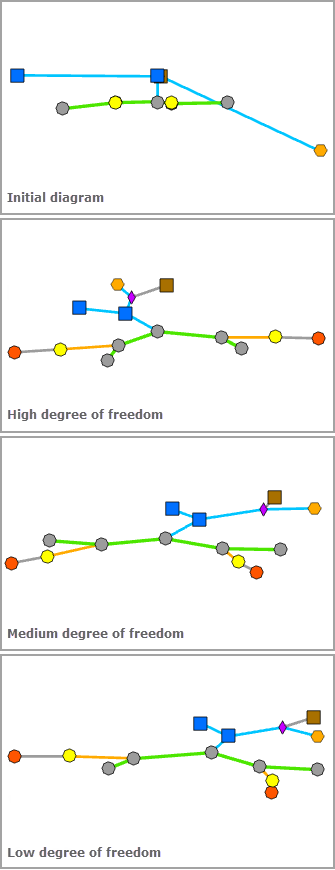

Degree of Freedom
This parameter is used to control the area used to move the diagram junctions during each algorithm iteration. It is a number between 0 and 100. The lower the degree of freedom is, the larger this area is.
The images below show the impact of different degrees of freedom when applying the layout to a sample diagram:
Force Directed layout—Degree of Freedom
