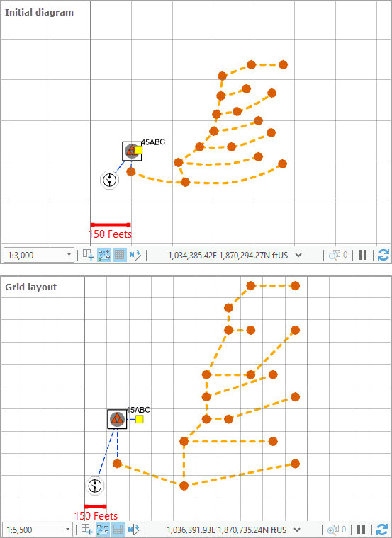

The images below show a sample diagram before and after applying the Grid layout:
Sample diagram before and after applying the Grid layout

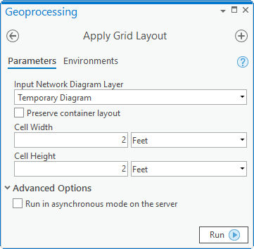

  • On the Network Diagram tab, click the drop-down arrow on the Diagram Layouts button in the Layout group, and click the Grid layout item in the gallery.
  • Load the Apply Grid Layout tool in the Geoprocessing pane, adjust the Grid layout parameters and click Run.

Apply Grid Layout parameters

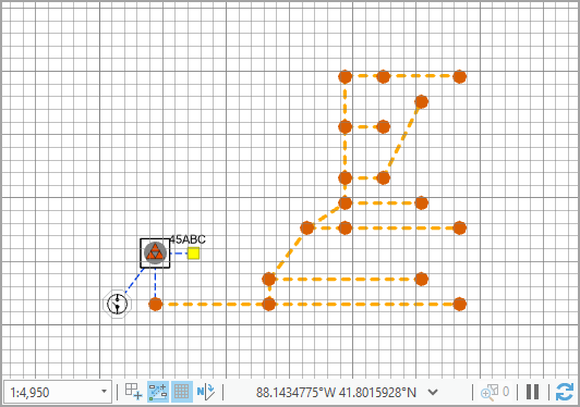

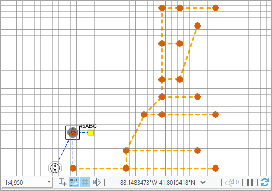

The image below shows the diagram before running the Grid layout:
Initial diagram
The following image shows the same diagram at the extent it is going to fit after the layout completion:
Initial diagram at the layout final extent

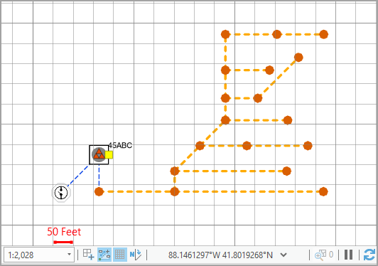

The image below shows the layout obtained after the Grid layout runs with Cell Width set to 150; this layout grid cell width corresponds to three cell widths in the map grid below:
Grid layout with Cell Width set to 150

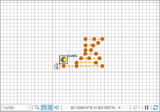

This second image shows the layout obtained after the Grid layout runs with Cell Width set to 100; this layout grid cell width corresponds to two cell widths in the map grid below:
Grid layout with Cell Width set to 100

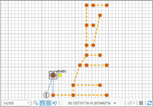

The image below shows the layout obtained after the Grid layout runs with Cell Height set to 150; this layout grid cell height corresponds to three cell heights in the map grid below:
Grid layout with Cell Height set to 150
