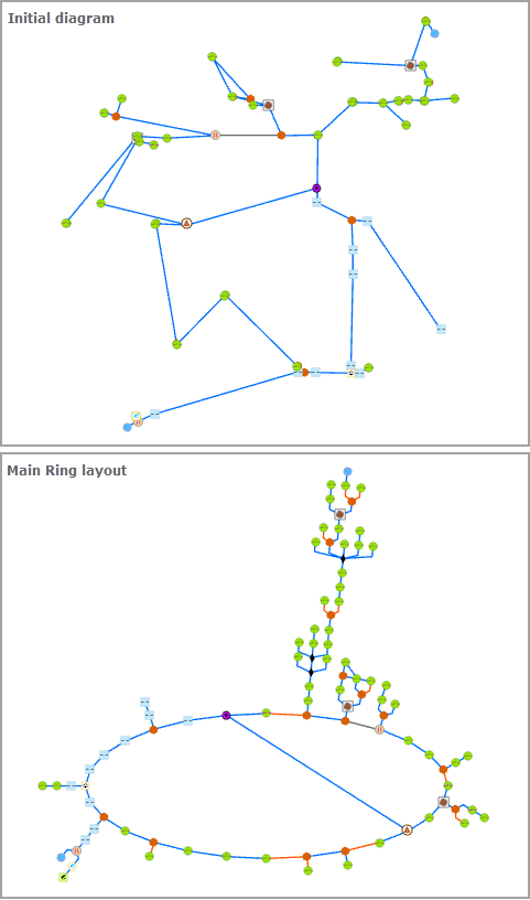

The examples below show a diagram before and after applying the Main Ring layout, respectively:
Before and after applying the Main Ring layout

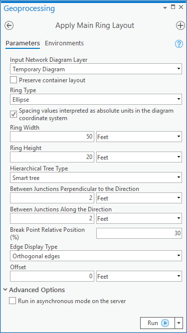

  • Load the Apply Main Ring Layout tool in the Geoprocessing pane.
Then, adjust the Main Ring layout parameters and click Run.

Apply Main Ring Layout parameters
Preserve container layout
Most of the layout algorithms work with the Preserve container layout option. When this option is checked, it allows you to control the algorithm application so it runs on the top graph of the diagram. When this option is not checked, the algorithm is applied to both content and noncontent features in the diagram.
Learn more about the Preserve container layout option
Ring Type
This parameter specifies the type of the ring, that is, whether the diagram features of the detected main ring will display along an ellipse (Ring Type set to Ellipse) or along a rectangle (Ring Type set to Rectangle):
Main Ring—Ring Type
Spacing values interpreted as absolute units in the diagram coordinate system
Some layout algorithms work with the Spacing values interpreted as absolute units in the diagram coordinate system option. This option specifies how the layout algorithm parameters representing distances will be interpreted:
  • Checked—The layout algorithm will interpret any distance values as linear units.
  • Unchecked—The layout algorithm will interpret any distance values as relative units to an estimation of the average of the junction sizes in the current diagram extent. This is the default.
Ring Width and Ring Height

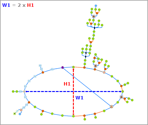

The Ring Width and Ring Height parameters are used to set the width and height of the ring. The examples below show a diagram after applying the Main Ring layout with different width and height values.
The first example shows the layout obtained with Ring Width set to W1 and Ring Height set to H1.

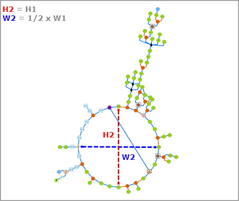

The next example shows the same diagram after applying the layout with Ring Width set to W2, equal to 1/2 W1, and Ring Height set to H2, equal to H1.

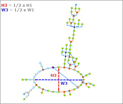

The third example shows the diagram after running Main Ring with Ring Width set to W3, equal to 1/2 W1, and Ring Height set to H3, equal to 1/2 H1.

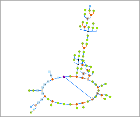

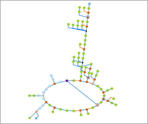

Hierarchical Tree Type
This parameter specifies how the trees coming out of the main ring's junctions will be positioned:
  • Smart tree—Each tree will be displayed hierarchically as a smart tree.
    Hierarchical Tree Type set to Smart tree
