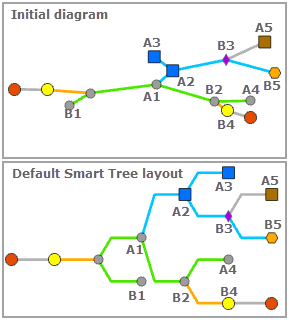

The examples below show a diagram before and after applying the Smart Tree layout, respectively:
Before and after applying the Smart Tree layout

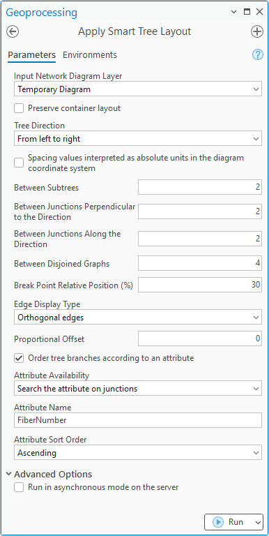

To apply the Smart Tree layout on an active diagram map view, do one of the following:
  • On the Network Diagram tab, click the drop-down arrow on the Diagram Layouts button in the Layout group, and depending on the tree direction you want, click one of the Smart Tree layout items in the gallery—, , , .
  • Load the Apply Smart Tree Layout tool in the Geoprocessing pane, adjust the Smart Tree layout parameters and click Run

The sections below clarify the main Smart Tree diagram layout parameters:
Apply Smart Tree Layout parameters

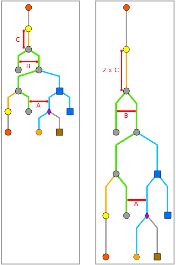

Between Subtrees
This parameter is used to specify the spacing between two neighboring subtrees, that is, the spacing between diagram junctions that are displayed perpendicular to the smart tree direction and belong to a different subtree, such as the A spacing below:
Smart Tree layout—Between Subtrees
Between Junctions Perpendicular to the Direction
This parameter is used to set the spacing between diagram junctions that are displayed perpendicular to the smart tree direction and belong to the same subtree level, that is, the B spacing below:
Smart Tree layout—Between Junctions Perpendicular to the Direction
Between Junctions Along the Direction
This parameter value specifies the spacing between diagram junctions that are displayed along the smart tree direction, that is, the C spacing below:
Smart Tree layout—Between Junctions Along the Direction

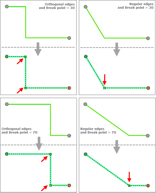

The Break Point Relative Position parameter specifies the relative position of the break point that will be inserted along the diagram edges when Edge Display Type is Regular edges or Orthogonal edges. It is a percentage between 0 and 100.
  • With a Break Point Relative Position (%) value of 0, the break point is positioned at the x-coordinate of the edge's from junction and at the y-coordinate of the edge's to junction for a horizontal tree. It is positioned at the y-coordinate of the edge's from junction and at the x-coordinate of the edge's to junction for a vertical tree.
  • With a Break Point Relative Position (%) value of 100, there is no break point inserted on the diagram edges; each diagram edge directly connects its from and to junctions.
  • With a Break Point Relative Position (%) value of N between 0 and 100, the break point is positioned at N% of the length of the [XY] segment, X being the x-coordinate of the edge's from junction and Y being the y-coordinate of the edge's to junction for a horizontal tree. It is positioned at N% of the length of the [YX] segment, Y being the y-coordinate of the edge's from junction and X being the x-coordinate of the edge's to junction for a vertical tree.
Break point relative position samples when using Orthogonal edges or Regular edges

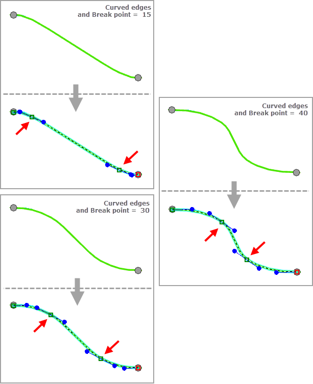

When Edge Display Type is Curved edges, the Break Point Relative Position parameter is used to compute the relative position of the two inflection points that will be inserted along the diagram edges to compute the curved edges geometry. It is a percentage between 15 and 40. With a Break Point Relative Position (%) value of N between 15 and 40, the following is true:
  • X being the x-coordinate of the edge's from junction and Y being the y-coordinate of the edge's to junction for a horizontal tree:
    • The first inflection point will be positioned at N% of the length of the [XY] segment.
    • The second inflection point will be positioned at (100 - N)% of the length of the [XY] segment.
  • Y being the y-coordinate of the edge's from junction and X being the x-coordinate of the edge's to junction for a vertical tree:
    • The first inflection point will be positioned at N% of the length of the [YX] segment.
The examples below show these inflection points when Edge Display Type is Curved edges, depending on different Break Point Relative Position parameter values:
Break point relative position examples when using Curved edges

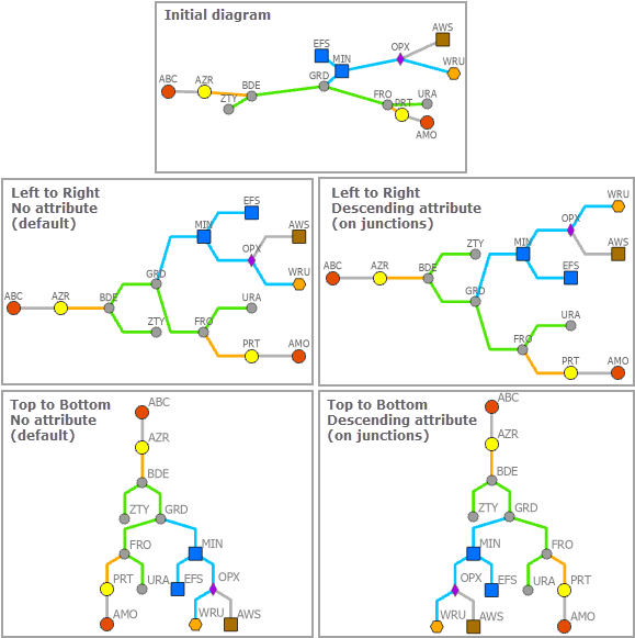

The Attribute Sort Order parameter allows to specify the sort order to consider for the tree branch positioning.
The sorting of the tree branches always applies from the first branch on the left to the last branch on the right for vertical tree layouts, and from the first branch at the top to the last branch at the bottom for horizontal tree layouts.
  • When you select Ascending in the Attribute Sort Order list, the tree branches will be ordered regarding the attribute field values in their ascending order. This is the default.
    For any horizontal tree layout, this makes the branch with the lowest attribute value to be placed at the top and the one with the highest attribute value at the bottom whether the tree structure is oriented from left to right or from right to left. Ascending for any vertical tree layout means that the branch with the lowest attribute value will be placed on the left and the one with the highest attribute value on the right, whether the tree structure is oriented from top to bottom or from bottom to top.
    Default Smart Tree layout result compared to when it is configured to sort branches in the ascending order according to an attribute that exists on lines
  • When you select Descending in the Attribute Sort Order list, the tree branches will be ordered regarding the attribute field values in their descending order.
    In this case, for any horizontal tree layout whether it is oriented from left to right or from right to left, this makes the branch with the highest attribute value to be placed at the top and the one with the lowest attribute value at the bottom. For any vertical tree layout, this means that the branch with the highest attribute value will be placed on the left and the one with the lowest attribute value on the right, whether the tree structure is oriented from top to bottom or from bottom to top.
    Default Smart Tree layout result compared to when it is configured to sort branches in the descending order according to an attribute that exists on junctions
