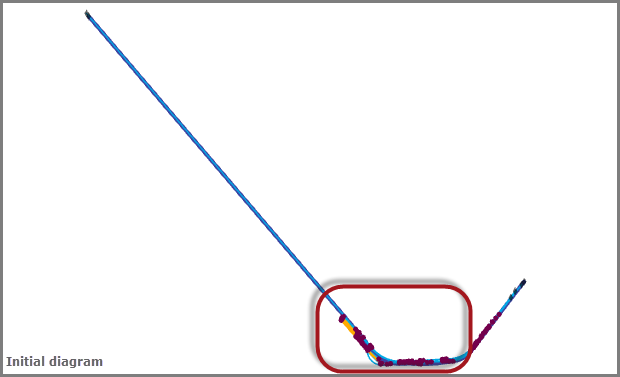

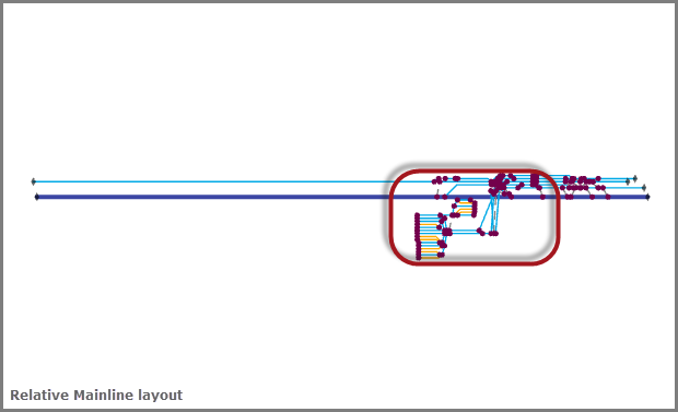

The examples below show a diagram before and after applying Relative Mainline, respectively:
Before applying the Relative Mainline layout
After applying the Relative Mainline layout

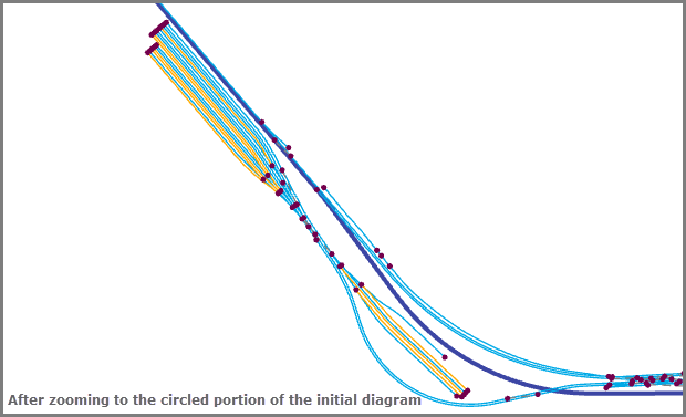

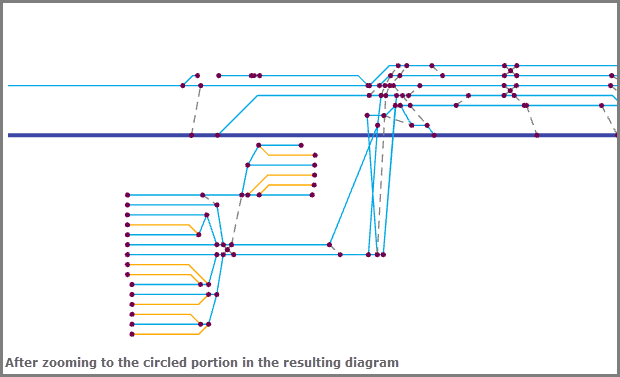

The following examples focus on the portion circled in the examples above before and after the Relative Mainline layout runs:
Zoomed in to the circled portion before applying the Relative Mainline layout
Zoomed in to the circled portion after applying the Relative Mainline layout

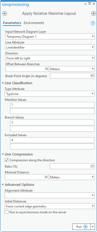

To apply the Relative Mainline layout on an active diagram map view, choose the Apply Relative Mainline Layout tool in the Geoprocessing pane.
Then, adjust the Relative Mainline layout parameters and click Run.
The sections below clarify the Relative Mainline diagram layout main parameters
Apply Relative Mainline Layout parameters.

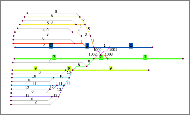

Line Attribute
This parameter is required. It sets the name of the network attribute that will be used to identify and group the edges that comprise the straight lines. This network attribute must exist in the network line classes. Its values should be the same for all the edges that comprise a straight line, for example, Line 1, Line 2, and so on. Edges with missing attribute values will be considered part of a branch.

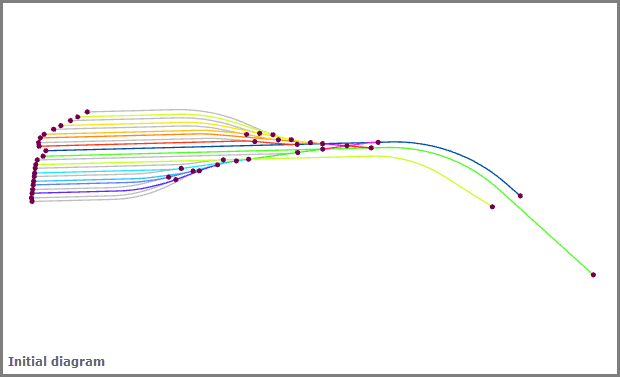

The examples below show a diagram before and after applying the Relative Mainline layout after specifying only the Line Attribute parameter, with the other attribute parameters not set by default:

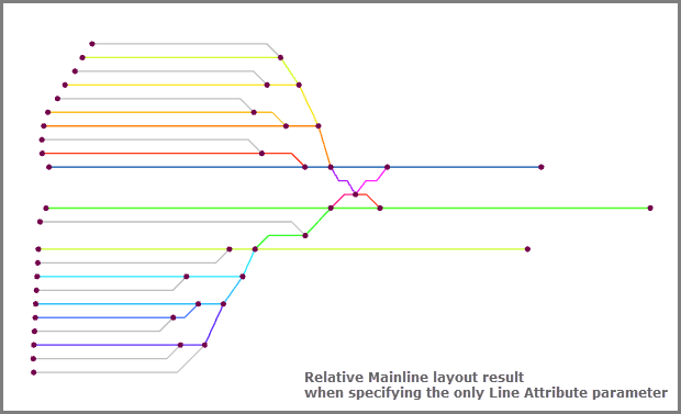

The example below shows each line with a given color according to its Line Attribute value; the Line Attribute values are also labeled in the image. The algorithm clearly groups the lines with the same attribute value and places each group of lines along the same straight line as far as possible:
Resulting Line Attribute values

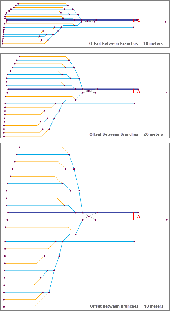

Offset Between Branches
This parameter determines the spacing between two adjacent branches along the axis perpendicular to the direction of the lines, that is, the spacing labeled A in the examples below for which the Relative Mainline layout applied with Direction set to From left to right:
Relative Mainline—Offset Between Branches

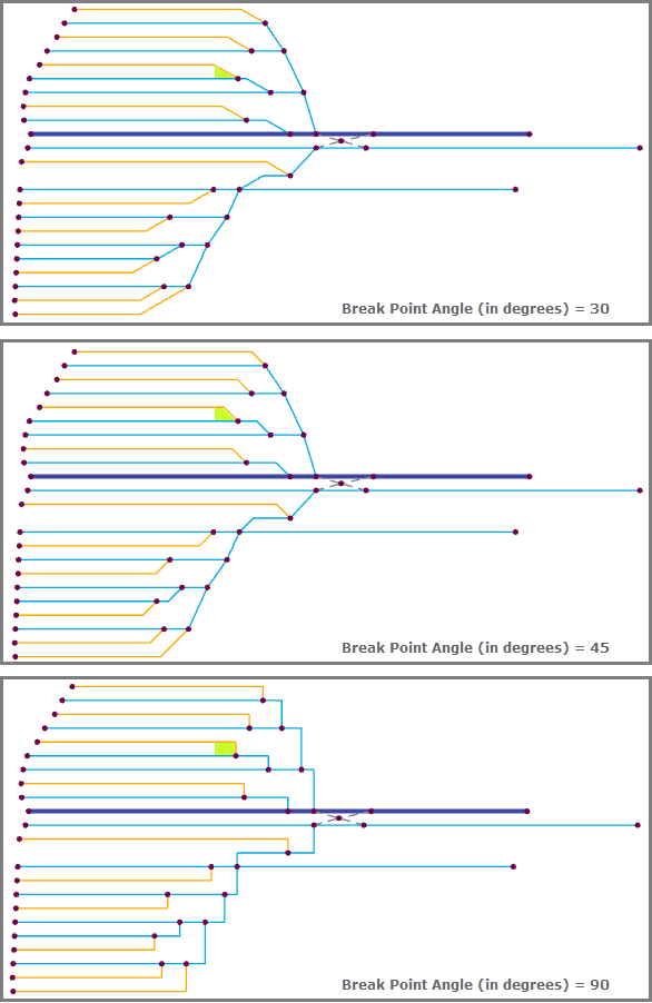

Break Point Angle (in degrees)
This parameter specifies the angle that will be used to position the break point on the branches. It is a value between 30 and 90 degrees that is combined with the Offset Between Branches parameter value to compute this position. When the break point angle value is 90 degrees, each branch displays orthogonally.
The examples below show a diagram laid out using different values for Break Point Angle (in degrees):
Relative Mainline—Break Point Angle (in degrees)

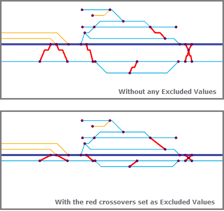

Type Attribute
This parameter sets the name of the network attribute the algorithm uses to qualify each line. This specific network attribute can exist in the network line classes. The network attribute name specified for the Line Attribute and Type Attribute parameters can be the same.
When this parameter is set, you must specify the type attribute values to help the algorithm identify the main lines, the branches, or any lines that must be systematically excluded, for example, crossovers or ladders. To do so, set all or some of the following parameters:
  • Mainline Values—These values are the type attribute values that can be used to distinguish the main lines from the other line types.
  • Branch Values—These type attribute values are those that clearly identify the branches among the other line types.
  • Excluded Values—These type attribute values identify the edges that must be excluded from the straight lines.
The examples below show a diagram after the layout run with no type attribute values set and with type attribute values specified for the Excluded Values parameter, respectively:
Relative Mainline—Excluded Values

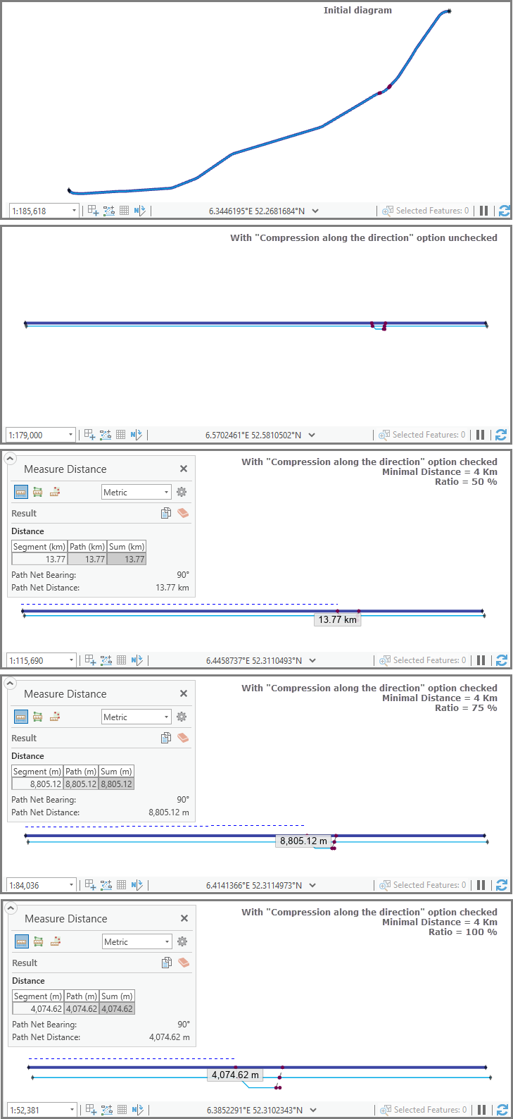

  • Ratio (%)—The compression ratio is a value between 0 and 100. It applies to each distance (such as D1 and D2 in the example below) that separates two adjacent groups of neighbor junctions (circled in orange below) after subtracting the specified Minimal Distance value, MD below. When Ratio (%) is 100, the distance between each detected junctions group is equal to the minimal distance, MD.
    Relative Mainline—Ratio and Minimal Distance parameters
  • Minimal Distance—The minimal distance is the distance that must be kept between two adjacent groups of neighbor junctions. This distance is also used to group neighbor junctions regarding their projection along the direction axis. Two junctions projected on this axis will belong to the same group when the distance between the two projected points is less than this distance.
The examples below show a diagram after the layout runs with different Ratio (%) parameter values and a fixed Minimal Distance parameter value:
Relative Mainline—Different compression ratios with the same minimal distance

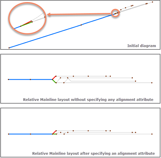

Alignment Attribute
This parameter identifies a network attribute whose values are used to resolve ambiguities on lines that are split. For example, your diagram includes the following characteristics:
  • There is a line (shown in blue in the first image below) that is split into two branches (one red and one green).
  • The Line Attribute and Type Attribute values are not relevant on these three lines to decide how to align them; that is, the Line Attribute values are the same for all lines, or they are all different.
In this situation, without specifying the Alignment Attribute parameter, the algorithm places the two branches on both sides of the blue line by default, as shown in the second image below.
Then, if there is another network attribute on the network line classes for which one of the branch lines and the blue line have the same values, this attribute can be specified as the Alignment Attribute value. When it is set, the algorithm uses it to systematically align connected lines that have the same Alignment Attribute values. For this example, the third image shows the Relative Mainline layout result when the blue and green connected edges have the same Alignment Attribute value and this attribute is specified.
Relative Mainline—Alignment Attribute
