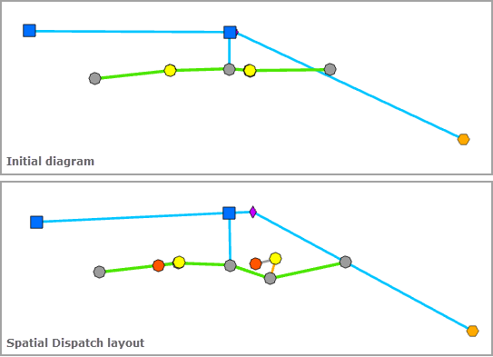

is a schematic layout algorithm that applies to any type of diagram.
This layout algorithm progressively separates diagram junctions that are visibly close to overlapping according to their current positions and to the shift factor specified.
The images below show a sample diagram before and after applying the Spatial Dispatch layout:

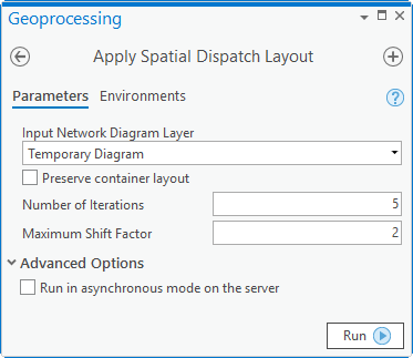

To apply the Spatial Dispatch layout on an active diagram map view, do one of the following:
On the Network Diagram tab, click the drop-down arrow on the Diagram Layouts button in the Layout group, and click the Spatial Dispatch
layout item in the gallery.Load the Apply Spatial Dispatch Layout tool in the Geoprocessing pane, adjust the Spatial Dispatch layout parameters and click Run.

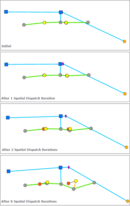

Number of Iterations
This parameter sets the number of iterations to process. The larger the number of iterations, the larger the separation between the diagram junctions that almost overlap, as shown in the images below:

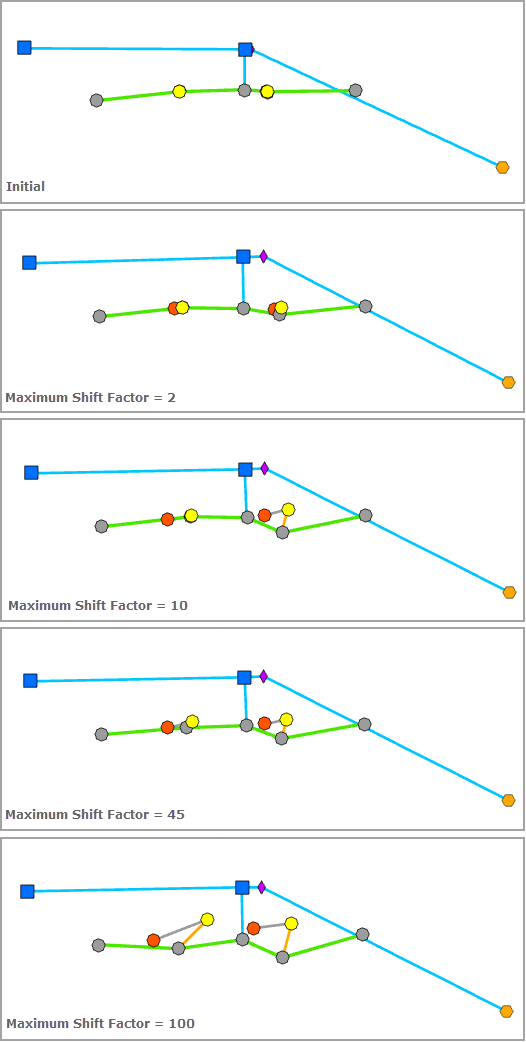

Maximum Shift Factor
This parameter is used to increase the diagram junctions' displacement for junctions that are very close together. The larger the shift factor, the larger the separation between the diagram junctions that almost overlap. The images below show how the sample diagram content changes after applying the layout with a fixed number of iterations and different Maximum Shift Factor parameter values.
