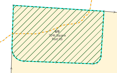

You can use the Split tool to split a parcel using an existing feature as a split line. For example, a river line that crosses over a parcel can be used to split the parcel. Another example is an easement line that crosses over a parcel can be used to split the parcel.
Natural boundary feature splitting a parcel
When splitting parcels with existing features, choose By Feature in the tool pane. Select the line feature to use as the split line for Input Features and select the parcels to split for Target Features.
Learn more about splitting features with existing features

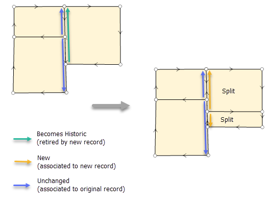

When parcels are split by a split line or existing feature, parcel attribute data is updated as follows:
  • The new split parcels are associated with the active record, which is the parcel record that created them.
    The Created By Record field of the new parcels is populated with the Global ID of the active parcel record.
  • The original parcels that were split become historic.
    The Retired By Record field of the original parcels is populated with the Global ID of the active record, which is the record that created the split parcels.
  • If the original parcels have Stated Area values, the Stated Area values of the new split parcels are updated to reflect the split areas.
  • If the original parcel lines have COGO attributes, the lines of the new split parcels have updated COGO distances. The COGO distance values are updated to reflect the distances of the split lines.
  • The COGO attributes of parcel lines between the new split parcels are null.
Parcel features are updated as follows:
  • Original parcel lines that are no longer used by other adjacent parcels are retired as historic.
  • New split lines are created for the new split parcel.
  • Boundaries that were not altered by the split remain unchanged and associated with the original record that created them.
