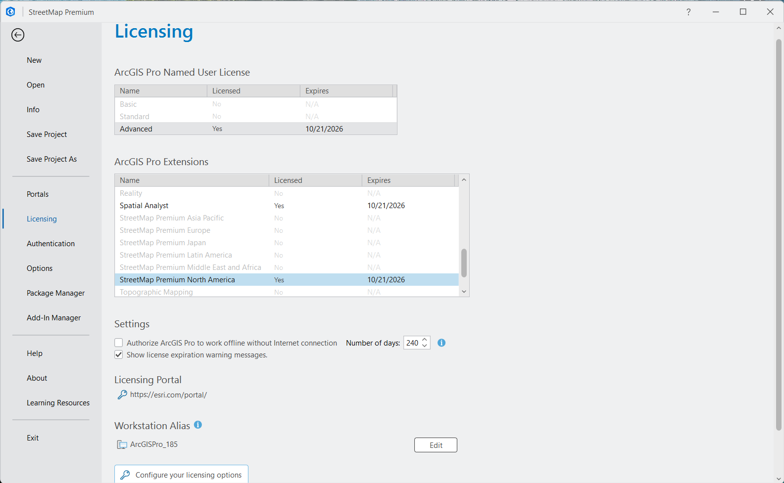

To verify you are licensed and provisioned for a StreetMap Premium extension, go to the Project tab in ArcGIS Pro and click Licensing to see the ArcGIS Pro Extensions list.
  1. Start ArcGIS Pro. For a Named User license, sign in using your organizational account that is licensed and provisioned with a StreetMap Premium extension.
  2. Click the Project tab.
  3. Click Licensing.
    The StreetMap Premium extension for which you are licensed is listed under ArcGIS Pro Extensions.
    Licensing pane showing the ArcGIS Pro Extensions list for StreetMap Premium
    Note:
    If a StreetMap Premium extension is not listed or is unavailable, your account is not licensed or provisioned, respectively, with the extension, and you will not be able to use a StreetMap Premium mobile map package. See Enable a StreetMap Premium extension above for information on how to have your ArcGIS Pro account licensed and provisioned with a StreetMap Premium extension.
