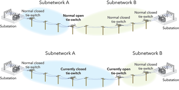

Changes to subnetworks
Subnetworks redefined by opening and closing dynamic switching devices
Because the extent of a subnetwork changes whenever an operating device is opened or closed, subnetworks are derived on demand. You can update the subnetworks in your utility network at any time. When you do, a network trace method is executed starting at the subnetwork controllers. The output of this trace method is used to update the Subnetworks table, attributes on features, and generate features within the SubnetLine feature class. This feature class contains multipart line features, representing all the connected lines for each subnetwork. These subnetwork lines can then be drawn with distinct colors to easily identify the extent of zones and circuits.
