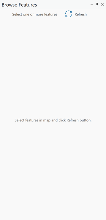

  4. On the Manage Quality tab, in the Semi-Automated Review group, click Browse Features .
    The Browse Features pane appears.

    If other features are selected in the map, click Refresh to display the new set of selected features.
  5. Select one or more features by clicking Select one or more features or Select by Rectangle and click Refresh .
    The features selected in the active map appear in the Browse Features pane.

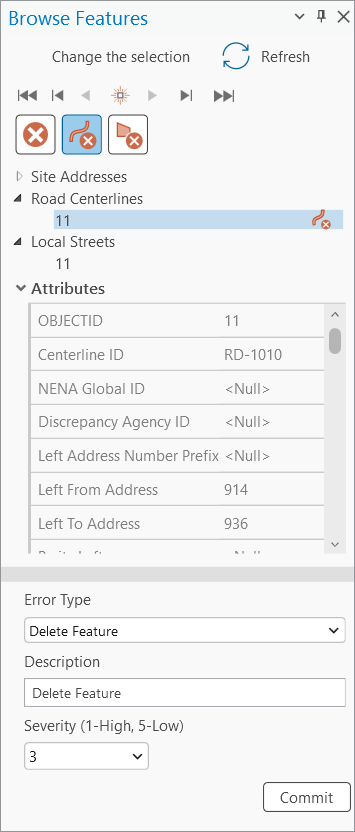

    Browse Features pane with a feature selected
  6. Click Next Feature or Previous Feature to browse through the set of selected features and evaluate each feature's geometry and attribution.

  8. In the result details section, click the Error Type drop-down arrow and choose the option that best describes the error.
    Browse Features pane Error Type drop-down menu
    The error type is selected, and the Description text box is automatically populated according to the error type.

  9. Optionally, click the Severity drop-down arrow and update the error feature's severity rank.
  10. Click Commit to write the feature as an error result in the error table.

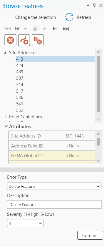

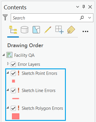

    Note:
    If you close and re-open ArcGIS Pro and the sketch geometry layers appear broken, you can remove them. This does not affect the tool or the project, as these layers are temporary.
    Broken sketch geometry layers in the Contents pane
