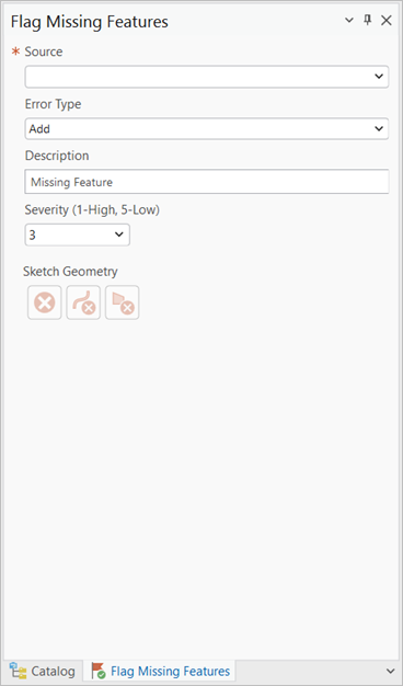

  5. On the Manage Quality tab, in the Semi-Automated Review group, click Flag Missing Features .
    The Flag Missing Features pane appears.

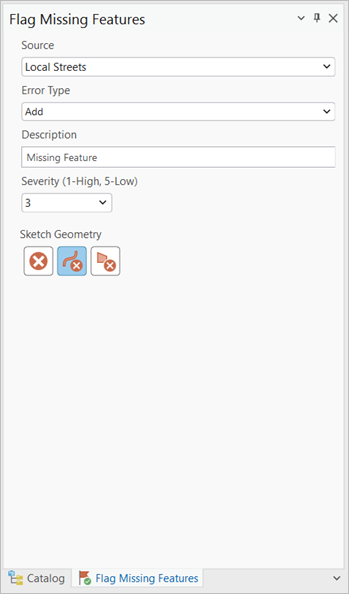

  6. Click the Source drop-down arrow and choose the feature class with the missing features.
    Note:
    Only feature classes that have visual review enabled appear in the drop-down menu.
  7. Click the Error Type drop-down arrow and choose the option that best describes the error.
    Note:
    If you choose Custom, the description can be edited to capture unique values.
  8. Optionally, choose the missing feature's severity rank from the Severity drop-down menu.
  9. Choose one of the following sketch geometry options to flag features as missing:
    • Point Error Error—Flag missing point features.
    • Line Error Review Line—Flag missing polyline features.
    • Polygon Error Review Polygon—Flag missing polygon features.

    Flag Missing Features pane with parameters filled
    Note:
    The Flag Missing Features parameters display the values that were last used.

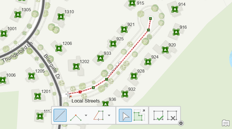

  10. Click the location where you want to add a missing feature in the active map and begin sketching.
    The pointer changes to the Flag Missing Features pointer and displays the name of the source feature layer and subtype.
    Note:
    Curve geometries are not supported geometry types for sketch geometries.
  11. On the construction toolbar, click Finish to finish sketching the error feature.
    The error is committed and displayed in the Error Inspector pane.
