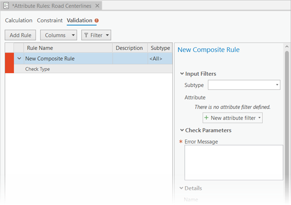

    A new row and grouping column are added to the Attribute Rules view and the Check Settings tab is activated.
  6. In the Composite check pane, configure common input parameters for the overall rule, including input filters, a defined error message, and details such as the rule’s name, description, severity, and tags.
    New composite rule in the Validation group

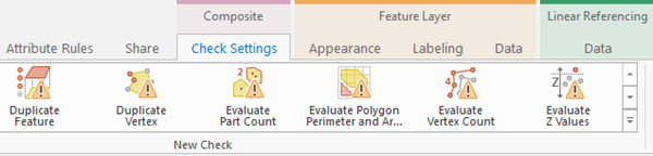

  2. On the Check Settings tab, expand the Ready to Use Checks gallery and click the first check to include in the rule.
    Note:
    You must have a composite check-based rule selected in the Attribute Rules view to activate the composite Check Settings tab. The contents of the Ready to Use Checks gallery vary depending on the chosen data source.
    Composite check gallery

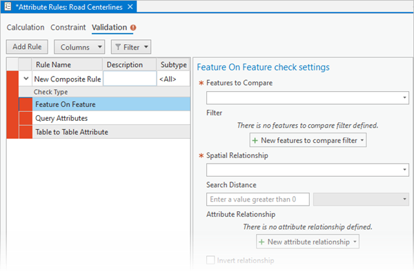

    A new row is added to the Attribute Rules view under the rule.
  3. In the check pane, configure check-specific settings.
    Each participating check contains a separate pane where check-specific parameters are set.
    New check parameters for the composite rule

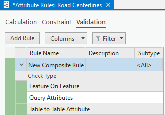

  4. Add at least one more check to the composite rule as outlined in the previous steps.
    Once you have added and configured a minimum of two checks for the composite rule, the row headers of the rule and participating checks turn green indicating that required parameters are valid.
    Completed checks for the new composite rule
