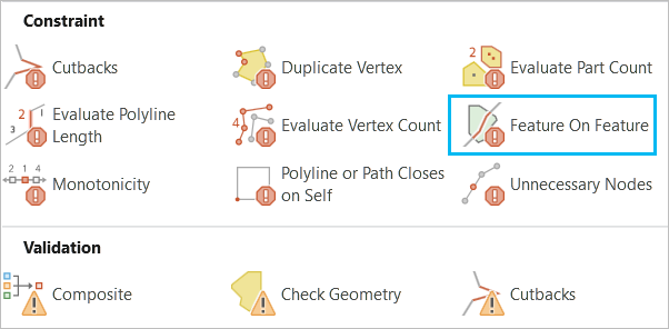

  7. From the Ready to Use Rules gallery, in the Constraint section, click Feature On Feature to add a new rule.
    Feature on Feature check in the Ready to Use Rules gallery

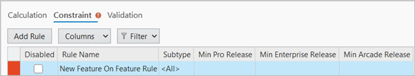

    The new rule appears in the Attribute Rules view with a red row header, indicating that required parameters are missing from the rule's configuration.
    Attribute Rules view with required parameters missing

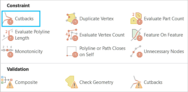

  1. On the Attribute Rules tab, in the Add Rules group, click the Ready to Use Rules drop-down gallery to display ArcGIS Data Reviewer automated checks.
    Note:
    The contents of the Ready to Use Rules gallery is a smart gallery that varies depending on the chosen data source.
  2. From the Ready to Use Rules gallery, in the Constraint section, click Cutbacks to add a new rule.
    Cutbacks check in the Ready to Use Rules gallery
