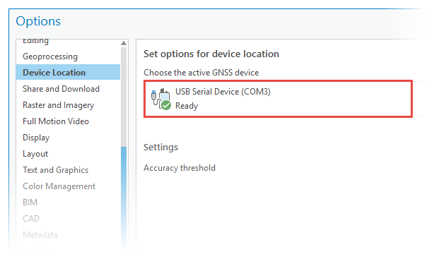

  1. Add the GNSS device to your project.
    1. On the View tab, in the Device Location group, click the Device Location Options dialog box launcher .
    2. Click the Device Location tab.
    3. Click the GNSS device arrow and choose the active GNSS device and set the accuracy threshold.
    4. To change the accuracy threshold, type the value in the Accuracy threshold text box, and set the units.
    5. Click OK.
