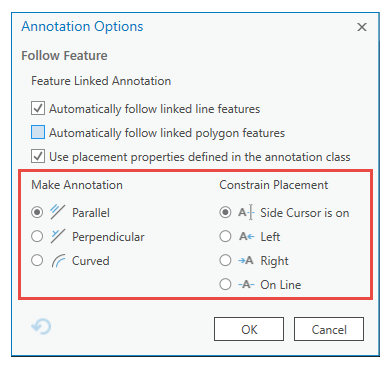

  9. To change the orientation of the text relative to the feature to which it is constrained, right-click and click Follow > Follow Feature Options , or press O.
    These settings are also available in the annotation project options for editing.
    Annotation Options
  10. To finish the feature, click Finish on the annotation editing toolbar, or press F2.
