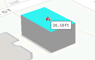

Move a face
To move a face, drag the selection anchor along a 3D axis handle when the pointer changes to the move cursor. Alternatively, you can use On-screen Constraints to type a value.
  1. Open a scene containing the multipatch or 3D object feature you are editing.
    Alternatively, add the layer containing the feature to the active scene.
  2. Configure settings for editing.
    Specify which layers can be edited, confirm that the coordinate system assigned to the active map is suitable for the type of edits you're performing, and enable the snap agents that allow you to work effectively with the multipatch or 3D object features you are editing.
  3. On the ribbon, click the Edit tab. In the Features group, click Modify .
  4. Click Edit Vertices in the Modify Features pane.
    To find the tool, expand Reshape, or type Vertices in the Search text box.
  5. Click the Select a feature tool , and select the multipatch or 3D object feature.
    If features are currently selected, the selection tool displays Change the selection.
    To refine the selection in the selection view, right-click a feature and click Unselect or Only Select This .
    The multipatch toolbar appears when only one feature is selected.
  6. Hover over the face you want to move.
    The selection anchor appears.
  7. Drag the selection anchor along a 3D axis handle when the pointer changes to the move cursor.
    Alternatively, turn on On-screen Constraints , drag the 3D handle along an axis, press the Tab key, and type the value in the on-screen text box.
    Note:
    To relocate the 3D anchor, press Ctrl and click the new location.
  8. To finish the feature, click Finish on the 3D editor toolbar, or press the F2 key.
