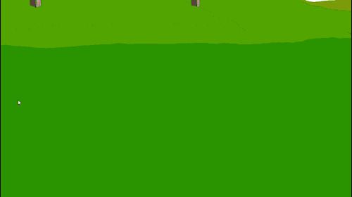

    See the following example:
    Create 3D geometry.
    An example workflow shows basic multipatch construction techniques.
