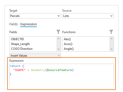

    Field Mapping Fields
    Tip:
    Click the Expression tab to confirm field mapping is correctly returning only the Shape field from the source feature, for example: return { "SHAPE" : Geometry($sourceFeature)}.
    Field Mapping Expression
