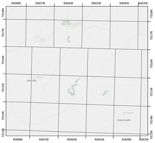

Custom grids are based on a polygon or line feature layer in a map. The polygon or line features act as the gridlines, and the custom grid allows you to label those lines outside the map frame. The labels are created from the features that intersect the map frame edge. One example of a custom grid is a township and range grid, shown below.
Example of a custom grid based on township and range data
