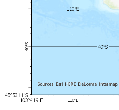

Add corner labels
This graticule includes gridlines, ticks, and labels. The graticule is not limited to what's included. You can add more components to the graticule. You will start by adding corner labels to provide a clear point of reference for the map.
  1. In the Element pane, on the Components tab , click the Add drop-down menu and choose Add Corner Labels.
  2. Zoom to the lower left corner of the layout to better see the corner labels.
    By default, corner labels are added to all corners. You will change this to show two labels.
  3. In the Element pane, under Corner Visibility, click Selected.
  4. Click Clear Selection to clear the selected edges. Then press Ctrl while clicking 1 and 3 to select both corners.
  5. Uncheck North-South and East-West to turn off those corners.
    The remaining corner labels show labels in the lower left corner and the upper right corner.
  6. Zoom out to the full extent of the layout.
    The corner labels may appear larger than the existing labels on the graticule.
  7. Under the Appearance heading, click Symbol to change the size of the corner labels.
  8. On the General tab, expand the Appearance heading and change Size to 8 pt.
  9. Click Apply.
  10. Click the back button to return to the Components tab .

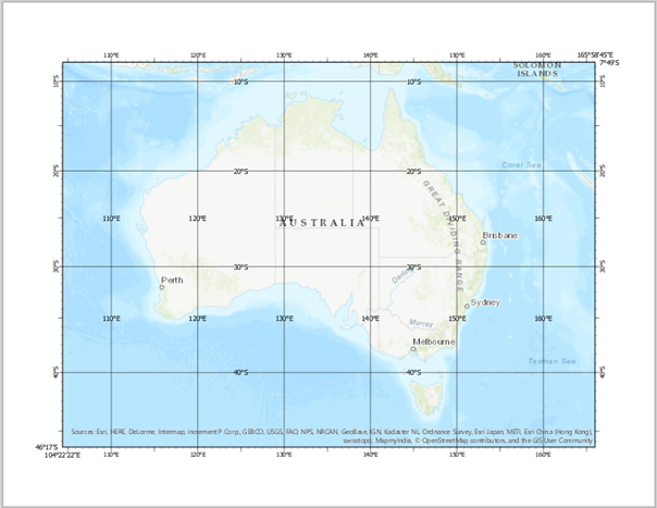

Customize intervals
When you insert a graticule, the Automatically adjust option is checked. This is the default setting so when the map frame is activated and you zoom in and out, the interval changes to avoid cluttering the map. You'll uncheck it to further customize the components of the grid.
  1. On the Options tab , uncheck the Automatically adjust check box.
  2. On the Components tab , click Gridlines. While pressing the Ctrl key, click Labels and Interior Labels.
  3. Under Interval, change Longitude to 10 degrees.
    By default, the Sync values option is checked. As changes are made to the Longitude interval, the Latitude interval is automatically changed to be the same. In this case, the intervals for both Latitude and Longitude are changed to 10 degrees. Uncheck this option to set different intervals for each axis.
    Example of labels

Final result
