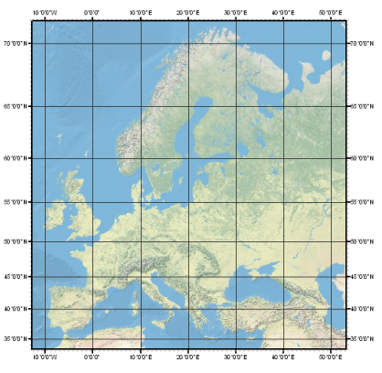

Graticules are a network of lines on a map that delineate the geographic coordinates (degrees of latitude and longitude.) You can add graticules to a map in any projection since all locations have a latitude and longitude.
Graticule example map
