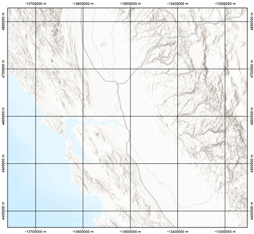

Measured grids, commonly referred to as grids, are a network of evenly spaced horizontal and vertical lines that delineate the projected coordinates of the map. To delineate lines of latitude and longitude, use a graticule.
Grid example map
