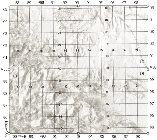

Military Grid Reference System (MGRS) grids are a type of measured grid. An MGRS grid is displayed in the universal transverse Mercator (UTM) coordinate system and can include information specific to that coordinate system, such as 100,000-meter grid zone labels.
MGRS grid example map

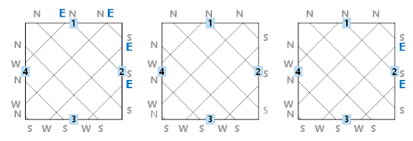

Under the Visible heading, use the cardinal direction check boxes to specify which ticks are shown. It is important to remember that the cardinal direction boxes refer to the direction the line is drawn, not how the line is labeled. For example, lines drawn north and south are labeled with easting and westing values.
Alternatively, on the Options tab , check Define map grid edges to control the visibility by the cardinal points at each map frame edge. On the Components tab , set Edges to Selected. Select one or more map frame edges and use the cardinal direction check boxes to set the visibility for only those edges.
Grids with ticks turned on and off for different edges
The first image is a grid with all ticks displayed. In the second image, East is not checked for all edges. In the third image, East is not checked for Edge 1 only.
Check Show edge visibility indicators to identify the edges with numbered buttons. Select an edge by clicking this button or choosing the number in the pane.

Under the Visible heading, use the cardinal direction check boxes to specify which labels are shown. It is important to remember that the cardinal direction boxes refer to the direction the line is drawn, not how the line is labeled. For example, lines drawn north and south are labeled with easting and westing values.
Alternatively, on the Options tab , check Define map grid edges to control the visibility by cardinal points for each map frame edge. On the Components tab , set Edges to Selected. Select one or more map frame edges and use the cardinal direction check boxes to set the visibility for only those edges.
Grids with labels turned on and off for different edges
The first image is a grid with all labels displayed. In the second image, East is not checked for all edges. In the third image, East is not checked for Edge 1 only.
