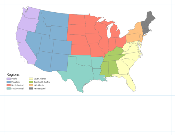

    The project opens showing a layout with a map of the US symbolized by region and a legend listing the various regions.
    The stating layout in the project

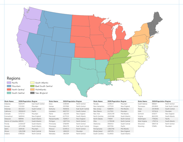

    A table appears on the layout. The red ellipse in the corner of the table frame element shows that not all the data is being shown. You'll fix this in the next step.
  5. In the Contents pane, expand the Table Frame element, and uncheck all fields except STATE_NAME, POPULATION, and REGION.
    The unchecked fields no longer display in the table frame. When creating a table frame, the first 10 fields are added to the table by default. To add more fields to the table frame, right-click the Table Frame element in the Contents pane and choose Add Field. To remove fields, right-click the field name under Table Frame and click Remove .
    The layout after adding the table frame and setting only the STATE_NAME, POPULATION, and REGION fields to be visible

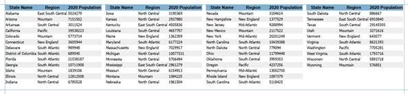

Reorder and sort the fields of the table frame
To reorder and sort the fields of the table frame, complete the following steps:
  1. In the Contents pane, select the REGION field.
  2. Drag the REGION field so it is between STATE_NAME and POPULATION.
    The table frame updates to reflect the field order change. Now the REGION field draws between the STATE_NAME and POPULATION fields on the table.
  3. In the Contents pane, right-click the Table Frame element and choose Properties.
    The Element pane appears.
  4. In the Element pane, click the Arrangement tab , and under Sorting, click Add Sort Field , and choose STATE_NAME.
    The table frame orders the states alphabetically.
  5. Under spacing, change the Frame columns value to 10 pt.
    The table frame columns update to be closer together.
    The table frame with reordered fields, sorted alphabetically

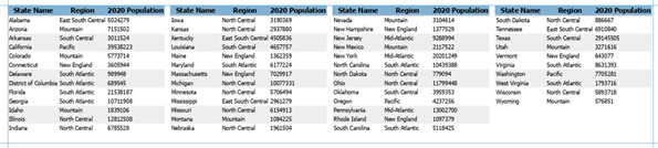

Modify the heading
To modify the heading, complete the following steps:
  1. In the Contents pane, right-click the Table Frame element, and click Properties to open the Element pane.
  2. In the Element pane, click the Display tab .
    This tab provides options for changing how the table frame looks, including options for the entire table, table cells, headings, and row backgrounds.
  3. Expand the Heading section if necessary, and under Heading, click the Text Symbol button.
    The pane state changes to provide access to text symbols.
  4. On the General tab , expand Appearance, and change Font name to Arial.
  5. Change Size to 12 pt.
  6. Expand Position, and change Horizontal alignment to Centered .
  7. Click Apply.
    The table updates. The headings are now centered and larger than the row text.
  8. At the top of the pane, click the Back button to return to the Display tab .
  9. Under the Heading section next to Background, open the color gallery and use the Eyedropper tool to select one of the region colors on the map.
    The table heading updates to have a background matching one of the region colors from the map.
    The table frame with the modified heading

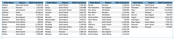

Modify a single field
To modify the number and text formatting for a single field, complete the following steps:
  1. In the Contents pane, right-click the Table Frame element, and click Open.
    The USA States attribute table appears.
  2. On the ribbon, click the Table tab, and in the Field group, click Fields .
    The Fields view of the table opens.
  3. Select the table row with the field name POPULATION.
  4. In the Number Format column for that row, double-click the Numeric cell value to show the Determine display formatting for numeric field types button.
  5. Click the button to open the Number Format dialog box.
    Table frames honor the Number Format settings for fields. Making changes to a field will update any table frames displaying the field, as well as the attribute table.
  6. Check the Show thousands separators check box, and click OK.
  7. On the ribbon, on the Fields tab, in the Manage Edits group, click Save .
    The table frame updates, and the POPULATION field values have thousand separators displayed.
  8. Close the Fields view of the table.
  9. Close the attribute table.
  10. In the Contents pane, right-click the POPULATION field, and choose Properties.
    The Element pane appears, displaying options for the POPULATION field.
  11. In the Element pane, under Display, next to Data Text, click the Text Symbol button.
  12. On the General tab , expand Position, and next to Horizontal alignment, click Right , and click Apply.
    The table frame updates, and the POPULATION field is right justified. The other fields remain left justified.
    The table frame with the modified population field. The population data has thousand separators and is right justified.

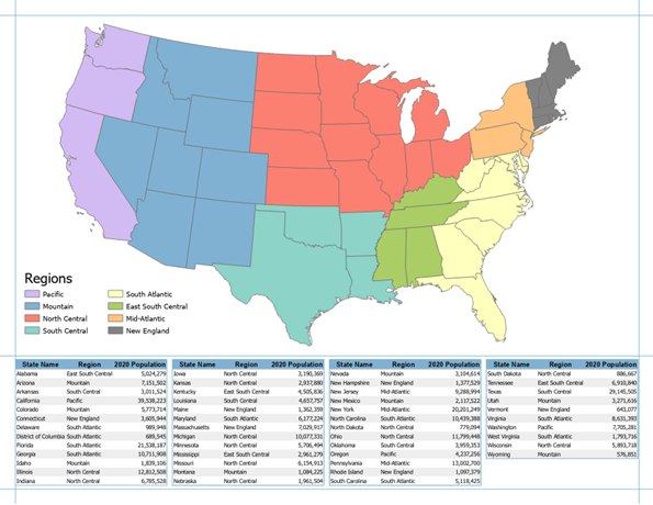

Modify the entire table frame
To format the entire table frame and finish the layout, complete the following steps:
    If the Element pane is already open, select the table frame in the Contents pane to show its properties. The Element pane always shows the properties of the selected layout element.
  3. Under Table, for Frame column border, open the color gallery and use the Eyedropper tool to select the same region color on the map you used for the heading background.
    A 1 point colored line is added around each table frame column, making the table easier to read.
  4. On the ribbon, click the Table Frame tab.
  5. In the Size & Position group, change Position from the Top Left position anchor point to the Center position anchor point.
    The table frame anchor point updates, and the table frame is now centered within its bounding box on the layout.
    The final layout with a map, legend, and stylized population table
