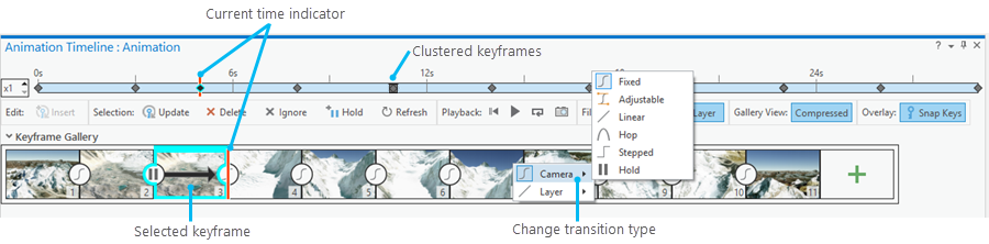

The image below shows the Animation Timeline pane with the timeline control shown as a blue horizontal bar with keyframes symbols (including a cluster), extra control buttons in the middle, and the keyframe gallery thumbnails along the bottom. The image below also shows where the current time is, a selected keyframe, a hold keyframe, and how to change a keyframe's transition type. The Animation Timeline pane is interactive and has context menus and keyframe selection to allow you to access editing capabilities.

Timeline control
Along the timeline, you can see the exact timing between keyframes, so you can observe how it would appear during playback or if exported to a video. Changing the distance between keyframes affects the speed of playback. Capabilities for working in the timeline are as follows:
  • Visualize time spacing.
  • Drag keyframes to rearrange.
  • Right-click a cluster of keyframes to expand and work with those grouped keyframes.
  • Right-click a keyframe for additional commands for editing and playback.
  • Drag the current time indicator to scrub through the current time.
  • Work with a selected keyframe or group of keyframes to perform edits.
Keyframe gallery
The gallery is used to visualize and edit the animation and easily work with selected keyframes. When a keyframe is selected in the gallery, the outline looks like a puzzle piece indicating how each keyframe and transition connect to form the animation. A keyframe and its transition type (located in front of each keyframe) are stored together. Capabilities for working in the gallery are as follows:
  • Drag keyframes to rearrange them.
  • Change the transition type for a keyframe by clicking the transition symbol on the keyframe.
  • View where a hold appears along the animation. These keyframes have an arrow indicating that properties are being held or paused from being animated.

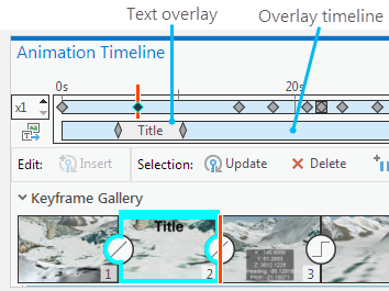

Overlay timeline
When an animation contains on-screen overlays for text, images, and shapes, a supplementary overlay timeline appears on the Animation Timeline pane. It only appears if overlays exist for the animation.
Overlay timeline for animations
Capabilities for working with the overlay timeline include:
  • Drag an overlay along the timeline to change the time it appears.
  • Drag either the first or last keyframe node on the overlay to adjust the duration.
  • Click Next Overlay to select the next overlay in the animation. This allows you to cycle through all overlays in the animation, not just those that are visible at the current time.
  • Edit properties for an overlay once it is selected. Properties are editable from the Overlay group on the Animation tab or using the Overlay tab on the Animation Properties pane.
