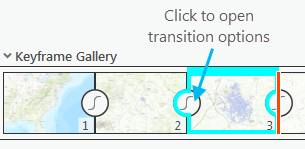

The Animation Timeline pane and the Animation Properties pane allow for more granular refinement in a more visual format. Connecting the keyframe thumbnail images on the Keyframe Gallery are circular symbols that allow you to click and customize transitions. Additional types are listed if you want to update transitions for the camera as well as for the layer.
Access keyframe transition options Available keyframe transition options

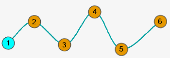

Fixed
A keyframe with a fixed transition creates a gradual and smooth change between itself and the previous keyframe. Fixed, or spline-type, curves can be described as making arcing or S-like shapes over time. For the camera, sequential keyframes with fixed transitions will provide a smooth curvature for the flight path. This is the default transition type for camera navigation.
Fixed transition
Create a smooth camera flight using a curved path with a fixed transition type.

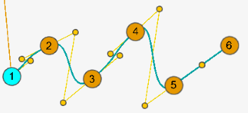

Adjustable
A keyframe with an adjustable transition creates a path with configurable smooth turns between itself and the previous keyframe. This transition type follows the mathematical logic of a Bezier curve. Control points are used to help define the shape of the curve.
Adjustable transition
Create a path with configurable smooth turns using the adjustable transition type.

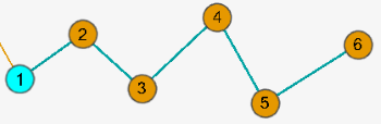

Linear
A keyframe with a linear transition creates a straight line between itself and the previous keyframe. Linear curves are known for making zigzag or Z-like shapes over time. For the camera, sequential keyframes with linear transitions will provide an angular or jagged flight path, which is useful for a straight camera flight such as through city streets. Linear is the default transition type for layer properties. This can be useful for transitioning a layer's visibility state to simulate a fade in or fade out effect.
Linear transition
Create a straight line camera path using the linear transition type.

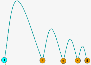

Hop
A keyframe with a hop transition creates an arc between itself and the previous keyframe. The camera experience along the path is a vertical jump, or bounce, between keyframes. When sequential keyframes are authored with hop transitions, the flight path with vertical arcs is well suited for a tour of key interest locations (for example, hopping from city to city).
Hop transition
Create a tour that bounces between keyframes using the hop transition type.
