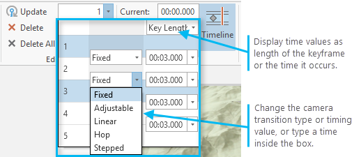

Animation Keyframe List
The Keyframe List is useful in many ways to your animation authoring workflow, allowing you to quickly do the following:
  • View the list of keyframes and quickly zoom to a position within the animation.
  • Get immediate feedback as to the location, duration, and type of keyframe being added.
  • Update timing between keyframes.
  • Update the camera-transition type between keyframes.

You can view the list of keyframe timing with one of two options: Key Length or Key Time. This means you are viewing the seconds between each keyframe, or as the total time for the animation to get to that position. In both cases, the values remain editable, allowing you to update the speed at which the camera moves between each of the viewpoints.

  • Choose the keyframe transition type—You can use Fixed, Adjustable, Linear, Hop and Stepped to influence how the camera travels between viewpoints.
  • Insert a hold—To temporarily pause the animation, you can insert a hold keyframe by choosing the one following the one you want it to append and clicking the Hold button . A hold, by default, is 2 seconds.
